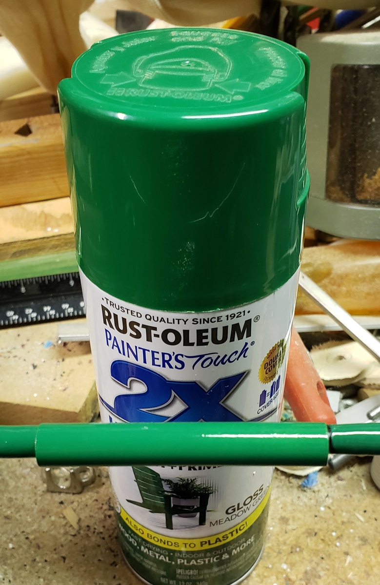

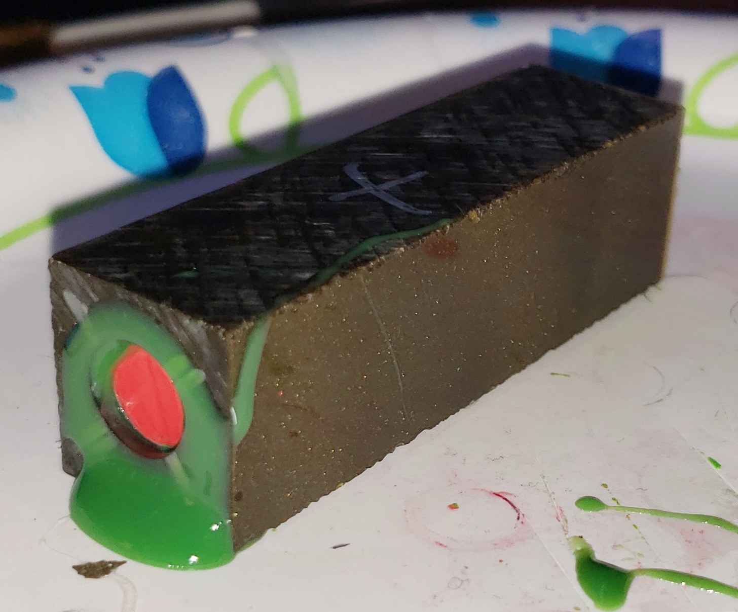

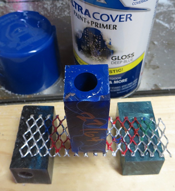

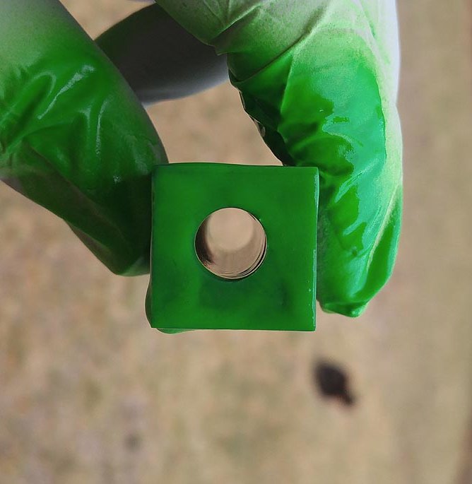

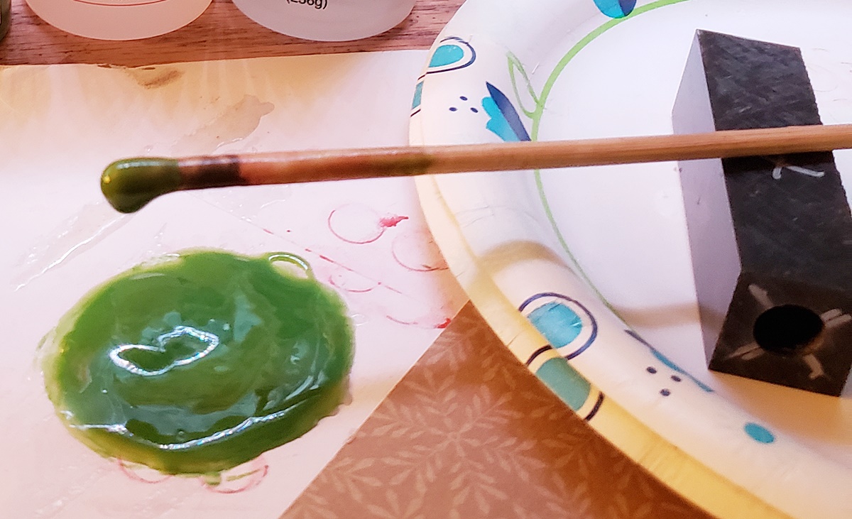

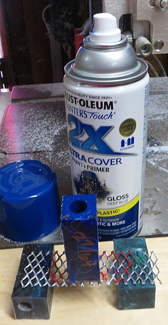

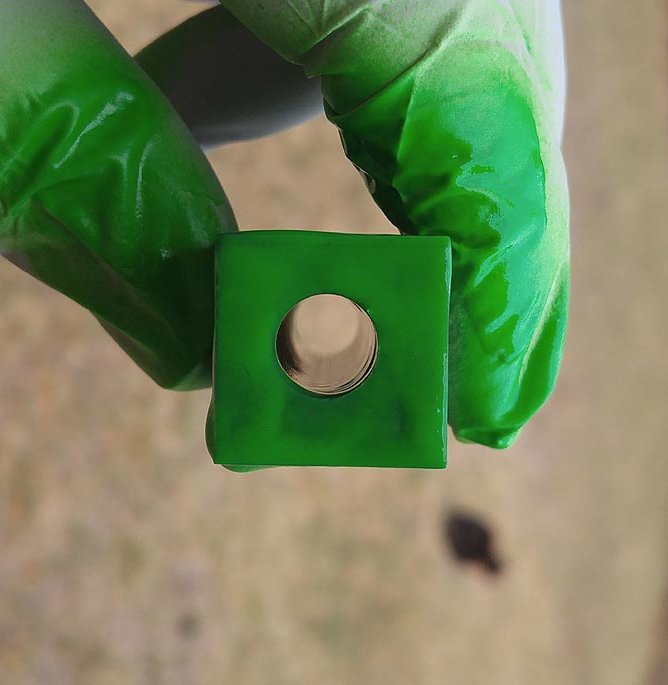

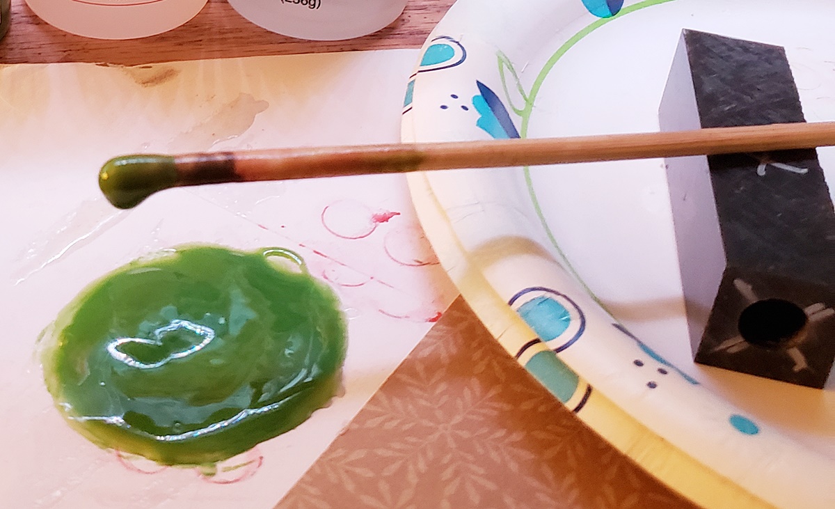

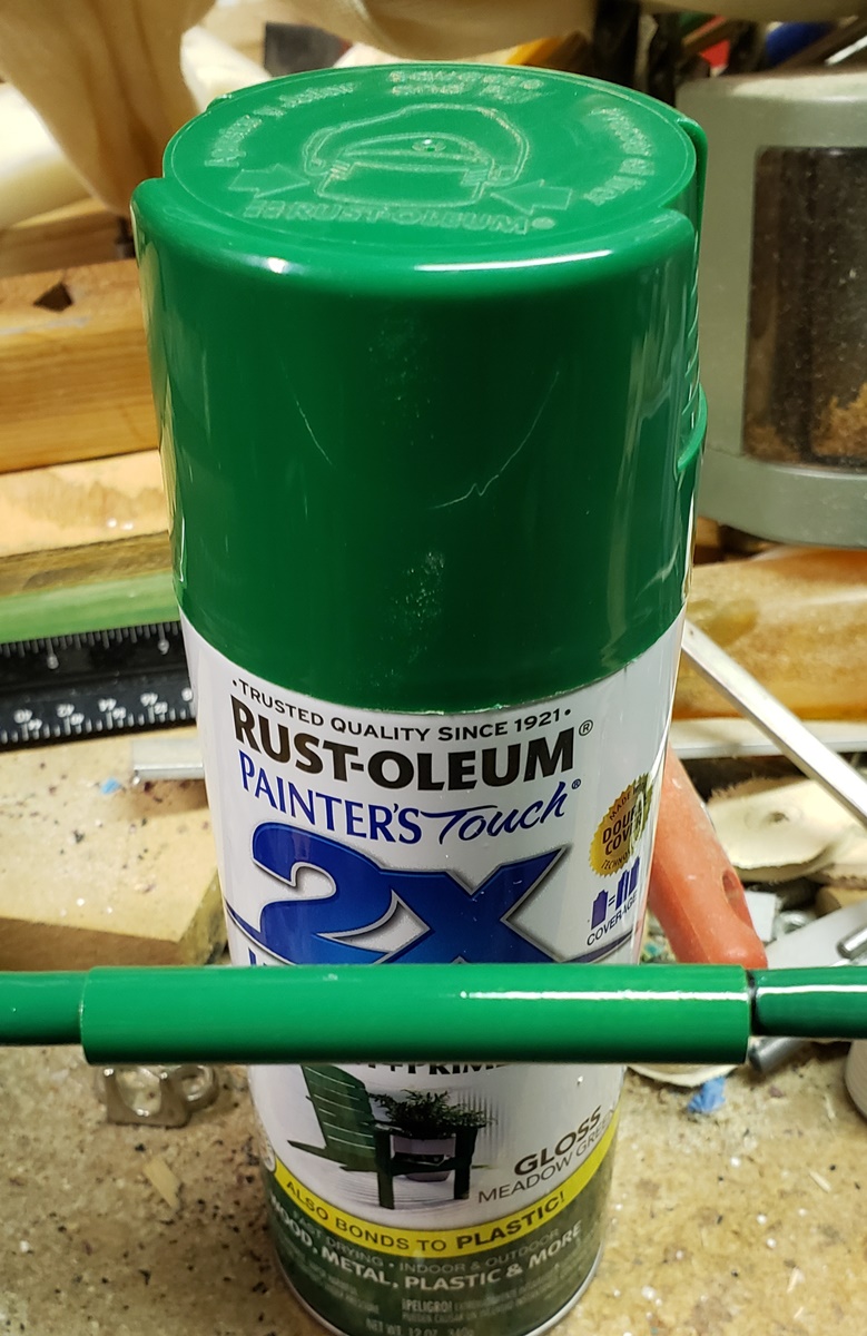

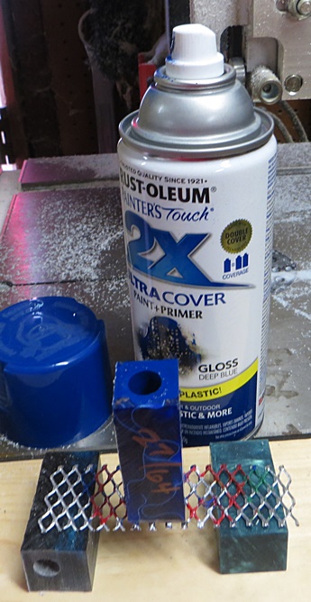

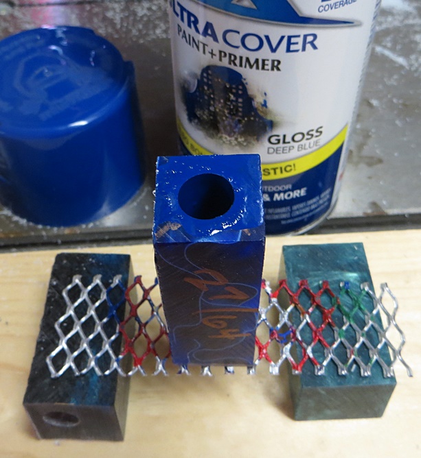

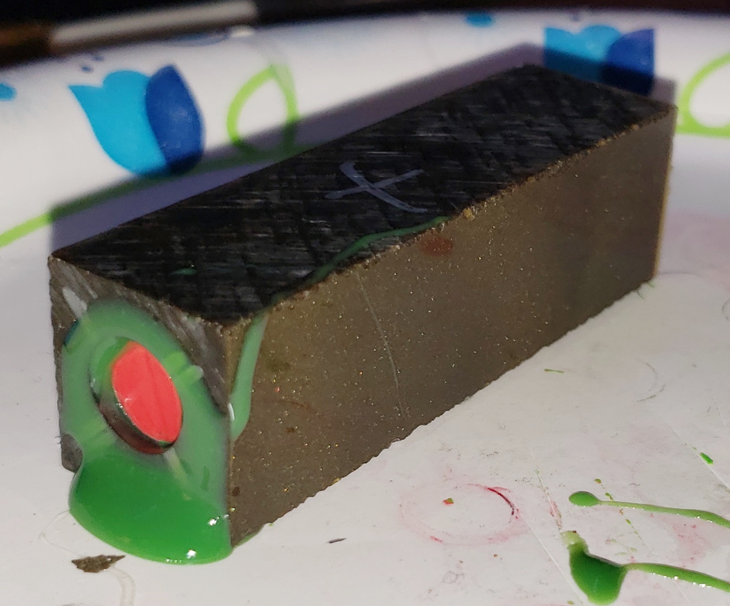

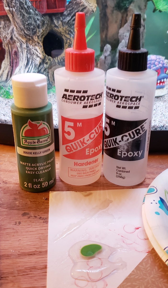

As does the Celtic. I always paint the tubes and color the epoxy with acrylic blanks, unless I'm 100% certain the blank is opaque. Sometimes I "back paint" the hole in the blank with especially translucent blanks.

Most with 8mm or 23/64 tubes. that accept a Parker refill (naturally "Cigars" and the like). I, too, prefer heavier walls.
Unless the blank is 100% opaque, I still paint barrels and tubes (then use epoxy).

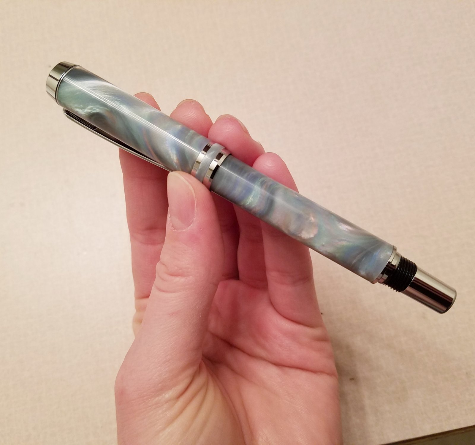

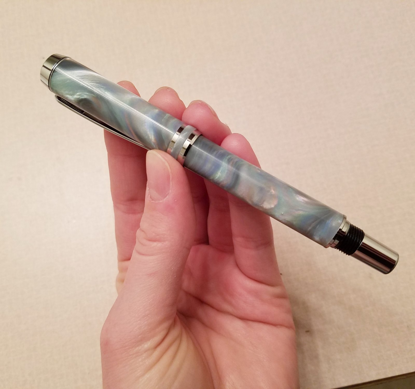

I've been back painting and coloring the epoxy for my transluscent pens. I actually really like the way they're turning out, but I'd like to see what they look like with more "meat" on the barrel as hokie said.
Here's one on a baron kit if anyone's interested :) Excuse the bad photo.
