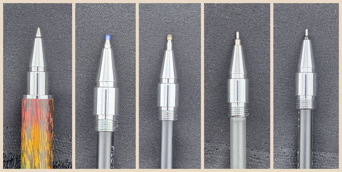

All rollerball pens I have tried will take the G2, but the tip doesn't always extend as far as the standard rollerball because the shoulder of the cartridge is slightly different. The Jr styles with the curved section don't work as well as the other ones I've tried.

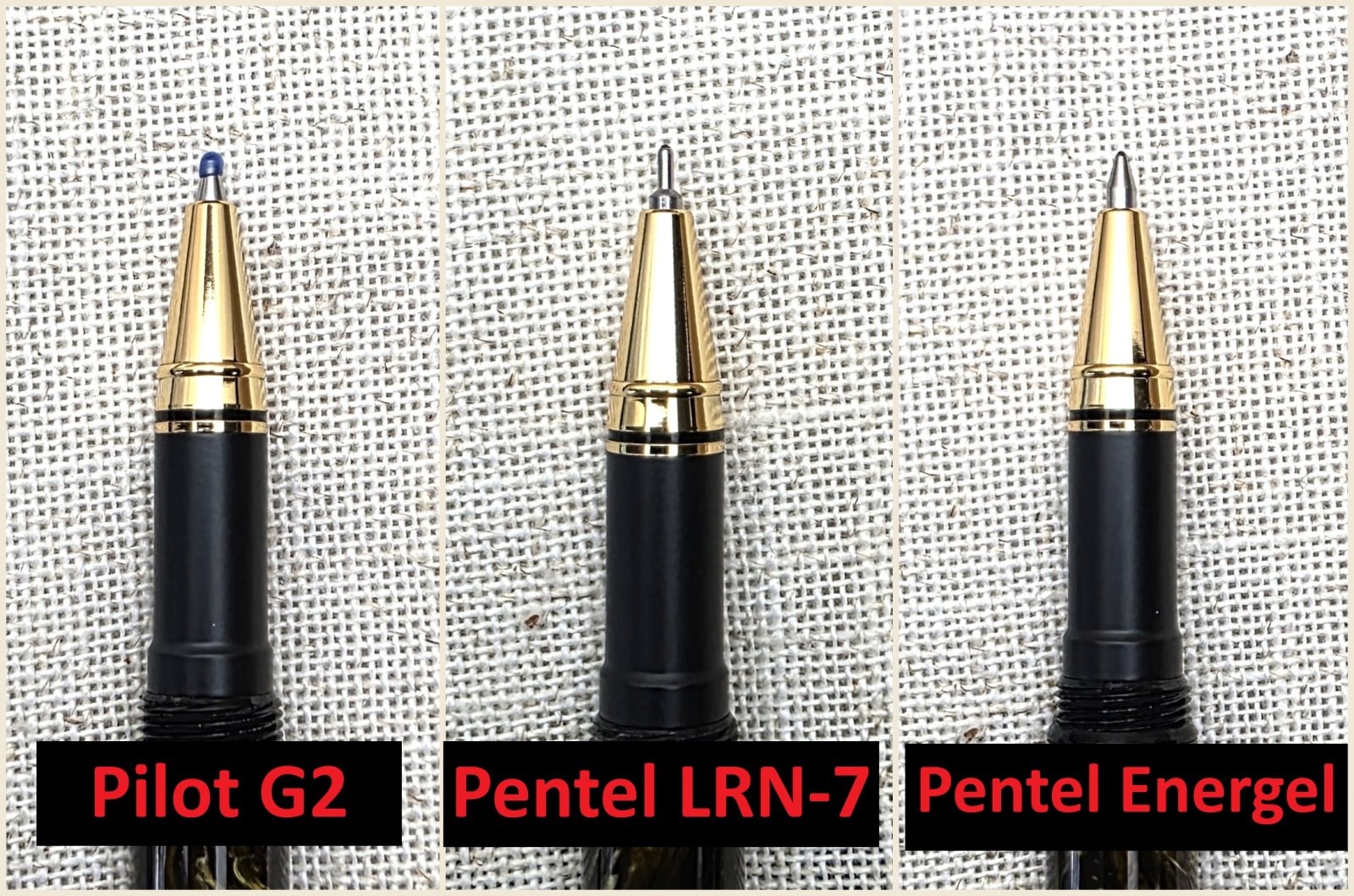

The first picture is of the PSI Classic rollerball (and Classic II). These are narrower than the Jr.s but make for really nice pens.
These are not labeled yet, but this is a Zen kit. The second one is the G2

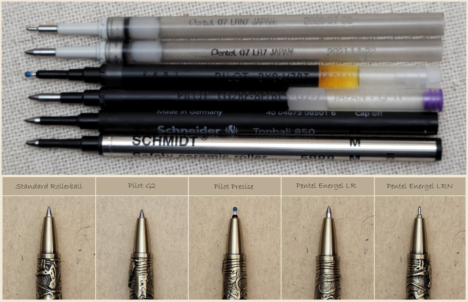

Let's see...
  1. Schmidt 888
  2. Pilot G2
  3. Pentel Energel
  4. Pentel LRN
  5. Pilot Precise
This one is a PSI fly fishing rollerball. You won't find one of those easily as they were discontinued, but the picture shows a good comparison of the refills
