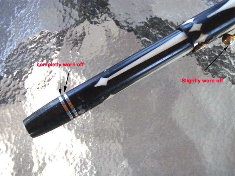

I have made well over a thousand pens and have only had one returned due to the plating and that was a flaw that was obvious. I have looked at a few pens that I have made and asked the owner to return it to me for a tuneup because I felt the plating was worn more than it should be. Is there a possibility that a customer is just used to the pen and doesn't mind the plating wearing since they are comfortable with the pen but we see it differently since we are used to seeing them new and pristine?
I got one guy that insists on carrying his pens in his front pocket along with his car keys and other items. It dont matter what plating is on that pen ... it aint gonna last 5 weeks.
I have rebuilt 4 of his pens and told him to either stop treating them like that or stop bringing them back to me.
I got 3 of his trashed out pens laying in my odds and inns bin and I do not intend on doing anything to them.
The photo shows a pen I made for him three or four years ago.
It has been completely rebuilt three times ... there will not be a forth.
This is the only pen I have seen TN coating wear.
The black nib part usually wears away to silver.
Any of you guys want this customer?

They will last a lifetime if you dont carry them around in your pocket and use them.
Just my personal opinion based on 9 years of pen making ... Chrome (if plated properly) will out wear anything else on pen parts.
Have not used enough TN yet to know if it actually lasts longer than chrome.
Of Course ...Your mileage may differ and I respect opposing views.
They will all wear - I have a "reliable vendor" cigar that I carry every day, day in an day out - for 5+ years now. (well it has been misplaced a few times). Black Ti plating is clearly worn through at the edges at the finial, center band (top section) and at the nib where it screws onto the black plastic insert. The CA finish is blotched, and there are some scratches on the clip.
Heavy use for multiple years -- yup. Problem -- just normal wear over time to me.
My daily writer in the office is a Chrome Baron Fountain. I have been using it nearly daily (okay 5 days a week) for about 2 years now.
The front section has the lovely spiral scratches that we hopefully have all learned to avoid (it was one of my first fountains), and the threads are starting to show some brass underneath (known weakness of the Barons). Otherwise the pen still looks great. Oh.... wait..... looking at it again..... nope, that's dirt. :wink:
