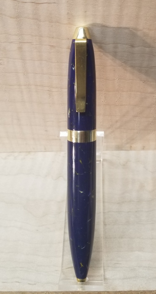

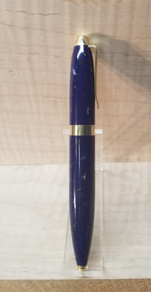

Wow, I struggled with this one. Made two previous versions of this pen. First one wasn't the right shape. The second one was perfect but it flew out of my hands while buffing and marred it badly:mad:

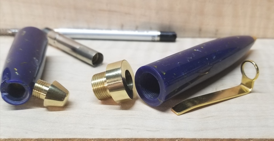

Versions one and two were made from Alumilite that I poured. This version is made from a Conway Stewart Lapis blank that I got from The Turners Workshop in the U.K. The clip is from the same place. The transmission is from Milans Pens I think (also available from Richard Greenwald - I order from both). The nose cone tip is from Richard Greenwald.
The center bad/adapter and finial are made from solid brass that I turned down and threaded.
The shape is a crude attempt to mimic the Dunhill AD2000 at the request of the buyer.
Thanks for looking,
Lewis
