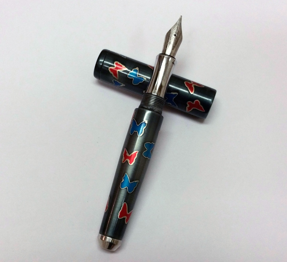

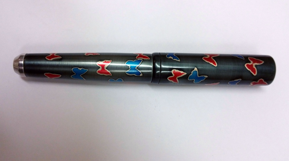

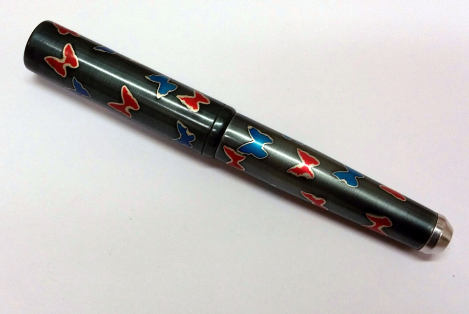

You may have caught my previous butterfly pen I posted yesterday which had some flaws which were bugging me. This time around I got the result I was looking for :smile:
I hope no one minds creating a new thread for this one.

I like the random outlines for the butterflies! They look very much an "intended" design element. Nice job!
The outlines are caused by leaving the pieces to soak in bleach in between dying the colours. The process is:
Anodise
Dye blue - and fan dry with cold air
Apply stickers
submerge in bleach to dissolve the exposed blue. The longer you leave it, it will soak in underneath the stickers and eat away at the outline giving the effect.
Rinse clean, and now dye it Red, and fan dry.
Process repeats.
The tricky part is judging how long to leave it in the bleach for. as you will see on my previous attempt, it ate pieces all over the place.. right up the middle in some instances. This time I got what I was after by ruffling the edges evenly
