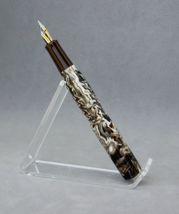

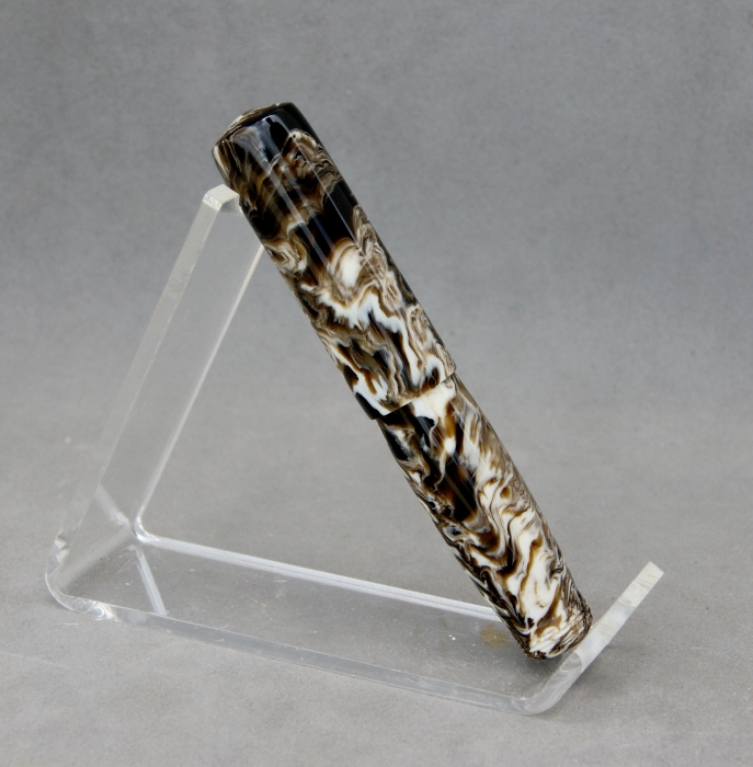

Brooks803
Sep 13, 2009
5,632
Aiken, South Carolina
Sorry to say, but a one-blank kitless pen is really hard to do. Jonathan Brooks (I think) figured out how to do it a few years ago. I looked through about 15 pages of his posts and couldn't find it - there are more pages to search
It's a mini FP and had to use another material for the section but yeah this one was all from one 5" blank.
I also make my own 9" rods with alumilite to have that seamless look on full sized pens.
