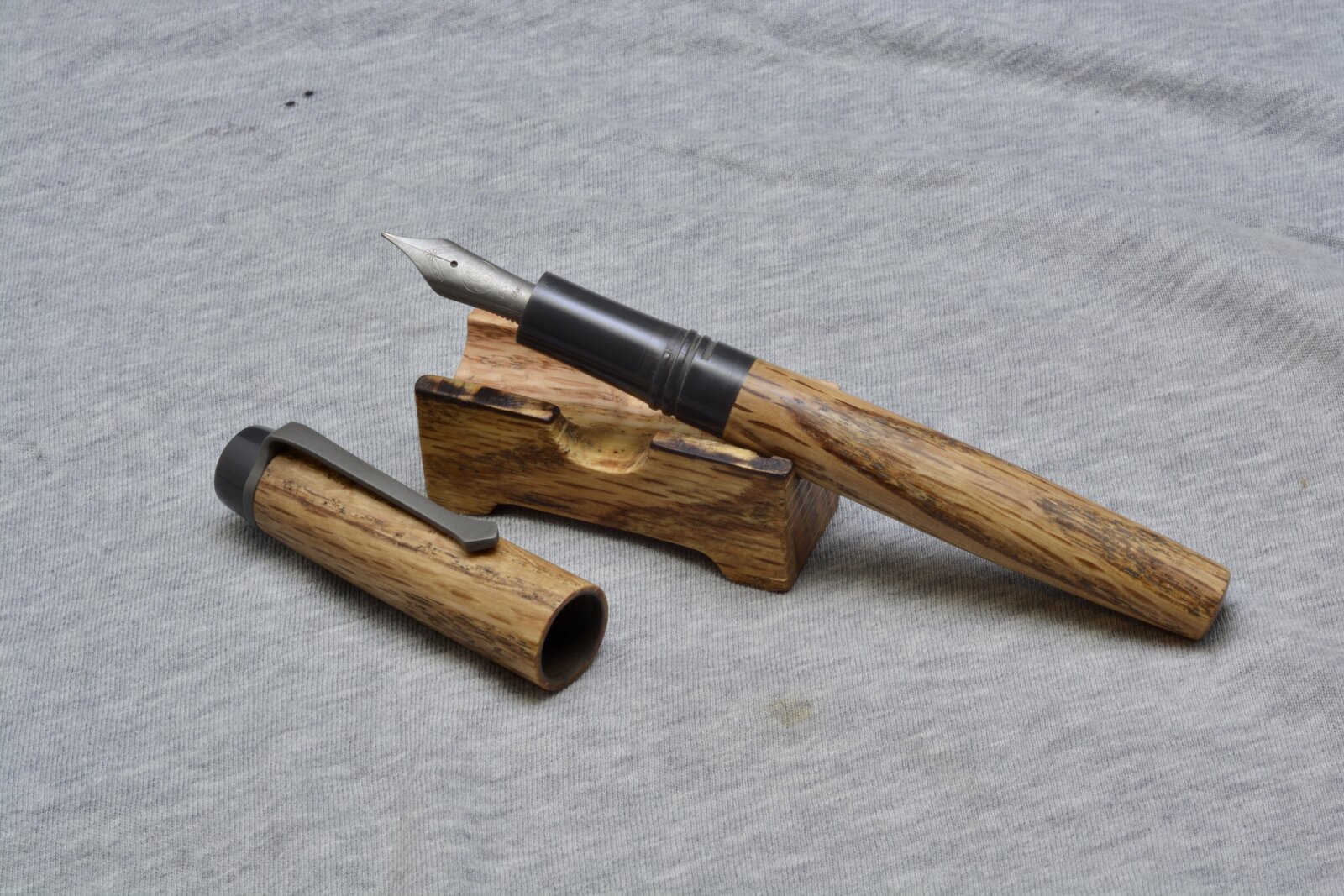

For my kitless pens made primarily from wood, I use brass tubes in the barrel, but not in the cap. I do it for the structural purposes you list, but I don't do any friction fitting. I just don't like to chance it by putting pressure on the wood. I do slip fits with epoxy for my components. I also like the brass tube, because I can use my closed-end mandrels made to fit in the tubes and I can finish the barrel before even adding any other components like the threads. If I could use brass in the cap, I would, but it's just easier to make the threads in the plastic liner material. Adding brass would just make the cap way too thick/stout. They are quite strong and haven't warped on me yet.

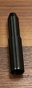

I'm not who you asked, but for the sake of contributing to the conversation, I typically make a sleeve already turned and threaded to be inserted and glued into a pre-drilled hole of a square blank. Looks something like this:
Once the epoxy is cured, I use a threaded mandrel to shape the square blank into the final shape and finish of the cap
