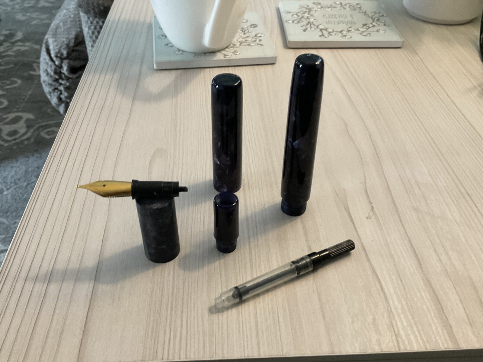

I'm with you Russ! Started this a few months ago after struggling through the you tube videos and reading everything I could find. Then I went out to the shop and just started trying to make all of the parts. After countless failures I started getting closer to a complete pen. That's when some of the things I had read started to click. Like cheap eBay taps and dies don't work and .025 mm is a lot. All I can say is the guys on this forum are the greatest. Huge help as I continue to struggle.

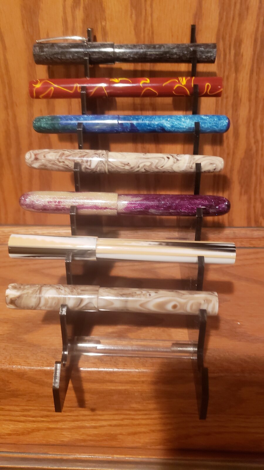

You Tube is a good source.
These pens were made on my wood lathe...Powermatic 3520B.
