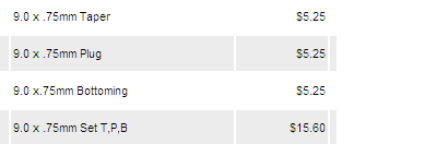

Because of this thread and mentioning the M9 x .75 we have sold out of that size tap and die. I have contacted all of my sources that sell this tap and die at a reasonable cost and have been told that there are none in country and that they are not on order. They are all looking at next year if at all for this set. Actually I have taps but no dies in country. (yes I have even bought out all the 1-1/2" dies I could find as well) You can buy this size on ebay from China for about $12 shipped. These are non-adjustable dies. This size is the critical size for me when it comes to the section to body connection. Until I can secure a large quantity of this die at a reasonable price, this idea will be on hold for me.

Amazon has M9 x.75 taps and dies, for those that really really need them.
Amazon.com: 9mm X .75 Metric HSS Left Hand Thread Tap M9 X 0.75mm Pitch: Home Improvement
So does another vendor....
The Amazon one is Left hand threads. I dont think its needed that badly.
They have right hand also
Amazon.com: 9mm X .75 Metric HSS Right Hand Thread Tap M9 X 0.75mm Pitch: Home Improvement
But the taps arent whats needed, its the dies.
Amazon.com: 9mm X .75 Metric Right Hand Thread Die M9 X 0.75mm Pitch: Home Improvement
And my other vendors do have the dies, just pointing out they are out there all ya gotta do is look. Both Split and solid
