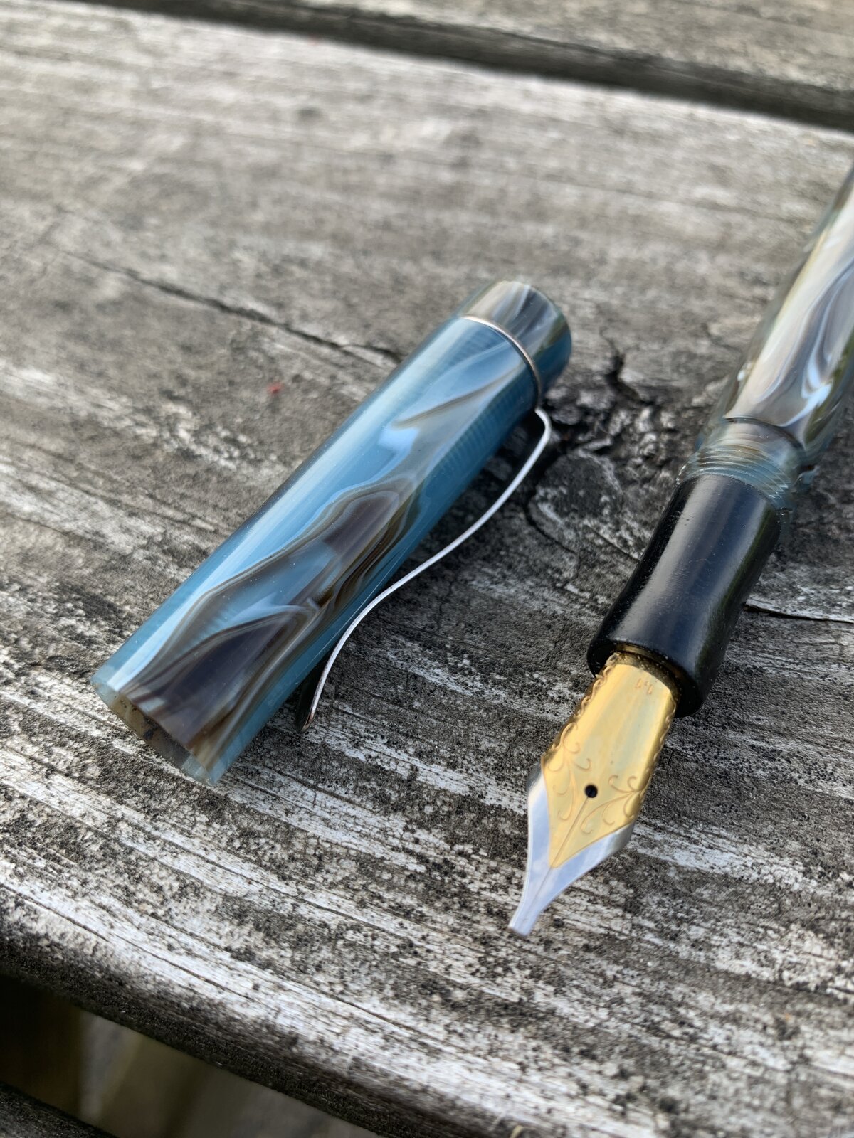

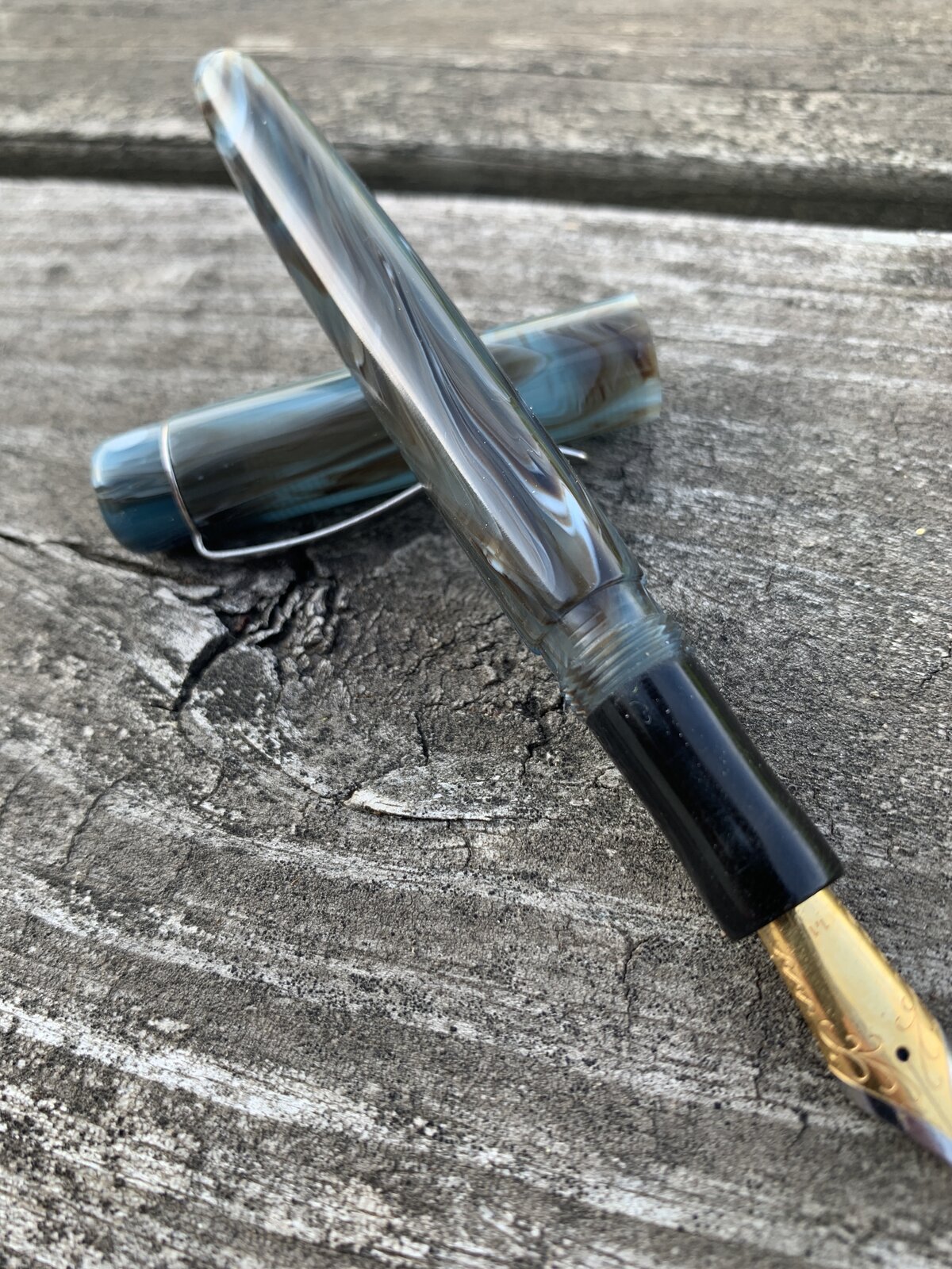

Another small pen for another writer: the barrel, at her request, is 12mm at its widest. I used an 11mm triple tap for the cap and barrel. I almost went with a #5 nib, since the Jowo 6 requires a final 8.5mm ID counterbore at the tip of the section, and paring the section down to around 10.2mm OD to fit into the cap doesn't leave a whole lotta wall left. But it's fine once the nib housing is seated. (This is why I prefer ebonite for sections- since I pare the section by hand, I could see acrylic crumbling under my marginally competent hands. :)

Very nicely done !!!
What clip did you use ? ..... or did you make it ?
That's my last "modern spoon" clip, purchased from Richard Greenwald about 3 years ago. To my knowledge, he hasn't offered them up again. I sacrificed one of the clips to make a template, so that I can make more, should I find myself more hours in the day.
