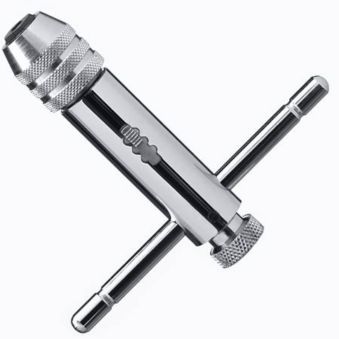

Check your tap holder, on mine the tip is reversible to work with the taps that go to a point. The reversed end has a small cup. The tip is removed by backing out the Allen screw from the taper end and reversing it.
Danny
Sent from my iPad using Penturners.org mobile app
I just used my Fountain Pen taps I got in a group buy and yep no way to use a guide. I tried drilling with a center bit but didn't even scratch it. I'll have to get a carbide center drill.

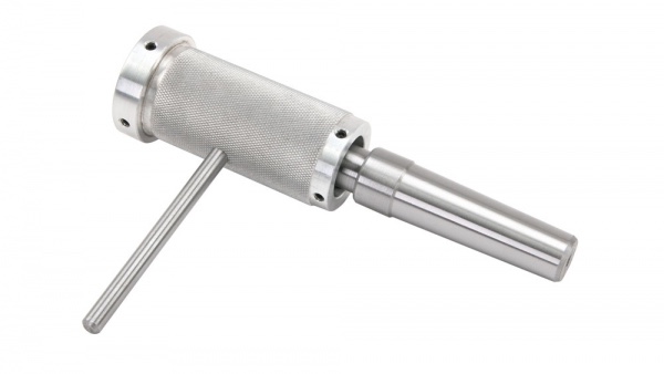

I use a tap holder like this. It has a small hole in the back end to fit my spring loaded center. Works great.
