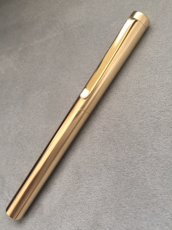

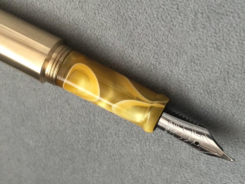

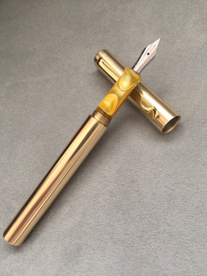

Kitless fountain pen #4. Brass body, cap, and clip with an acrylic front section. The nib is a #5 Bock in polished stainless.
Dimensions are:
Diameter: 0.490 inches
Length: 5.5 inches
Threads: Section 9mm x 0.75, Cap 11mm x 0.75

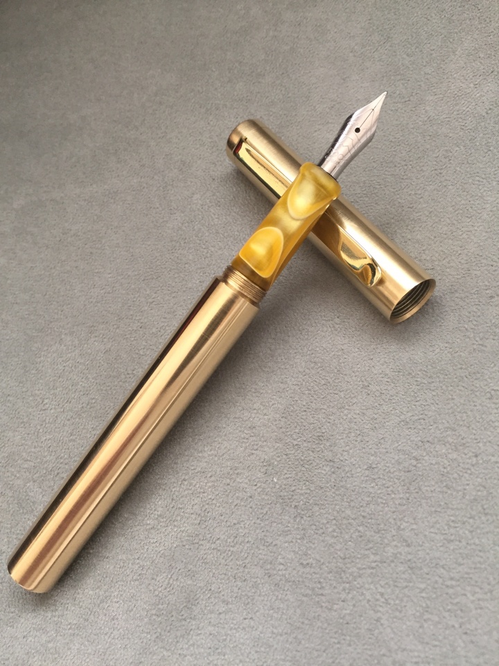

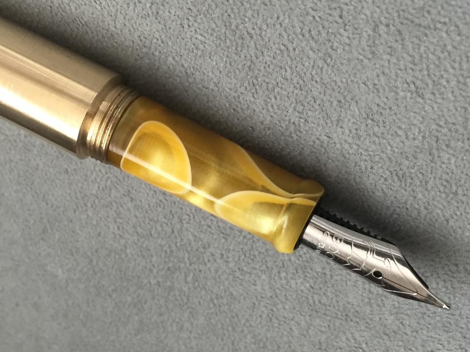

I'm sort of confused to why the acrylic was used for the section?
The brass work is beyond awesome. I can only think you ran out of brass?
Scott (super shiny) B
Scott plenty of brass. I wanted to try something new. Started with ebonite which broke after a week. Then made one with black Delren. And there was this left over piece of yellow acrylic begging to be used for something. I have some phosphor bronze to make my next pen. Started with aluminum and then 300 series Stainless Steel all metal.

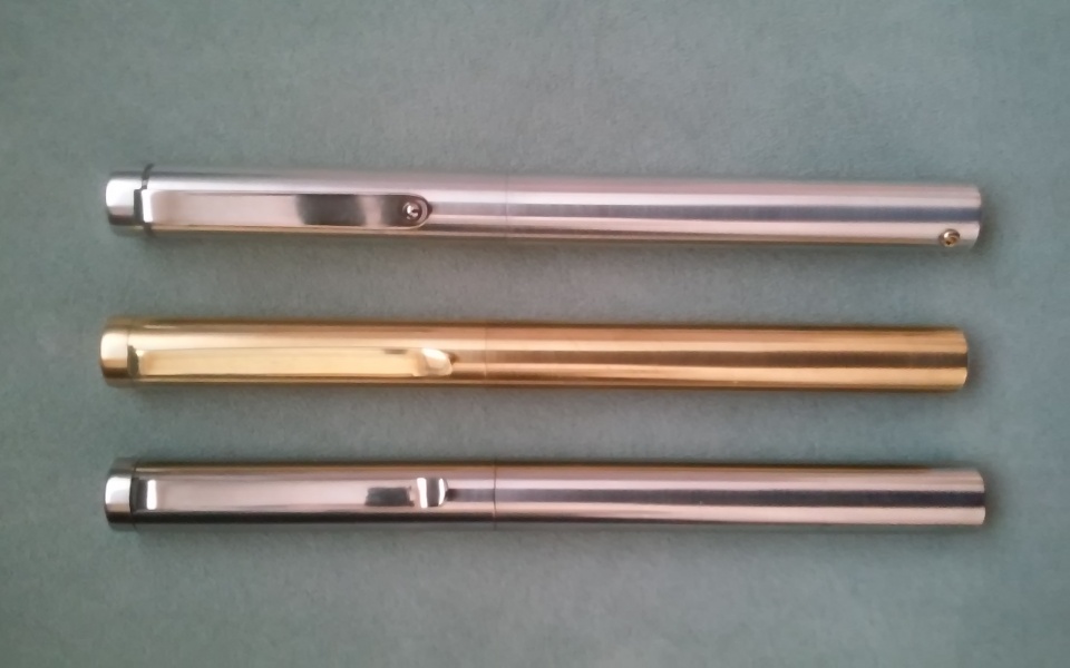

How heavy is the brass one? Does it post?
I am so trying to get onto my metal lathe. I made a couple of mandrels, to help with a shaving order, but thats it.

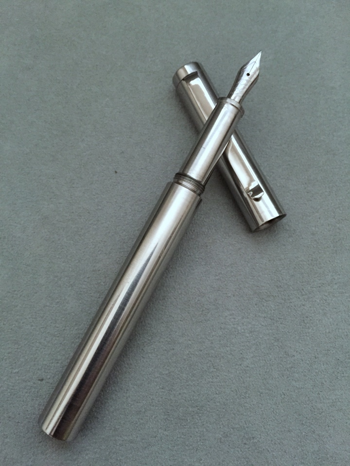

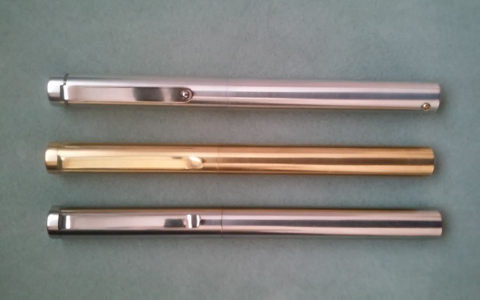

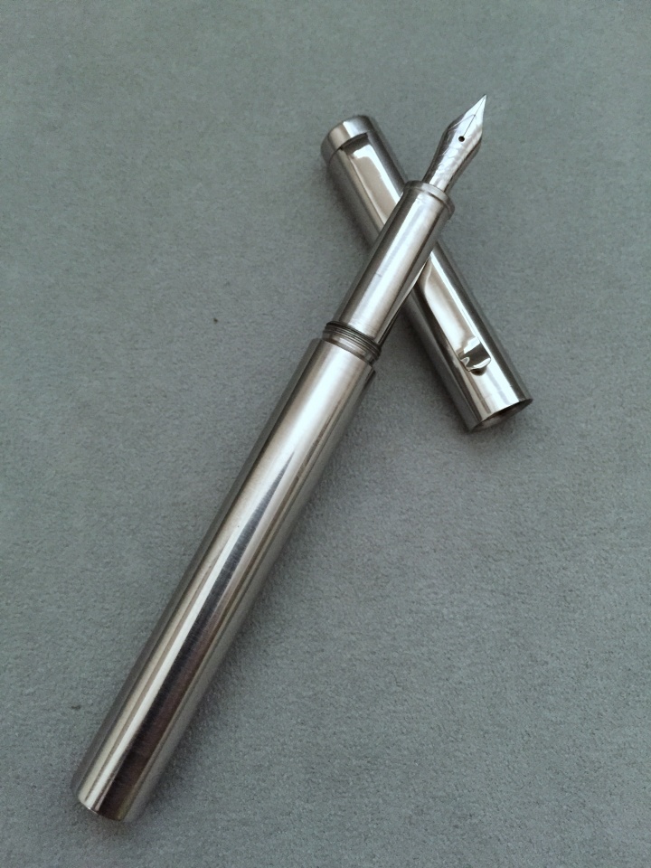

Is that bottom one the stainless or the alluminum? Either way it looks awesome. You should post a picture of the three together.
Thanks Darrin. The last one is stainless steel with a titanium clip. The aluminum is 1 oz / 27 grams. The SS is 3.1 oz / 89 grams. And the Brass is 2.9 oz / 82 grams. All weights with converter and ink. The caps do not post. I was going for a slick minimalist look and external threads wouldn't look quite right.

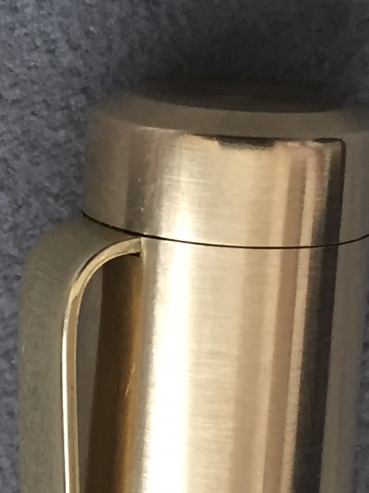

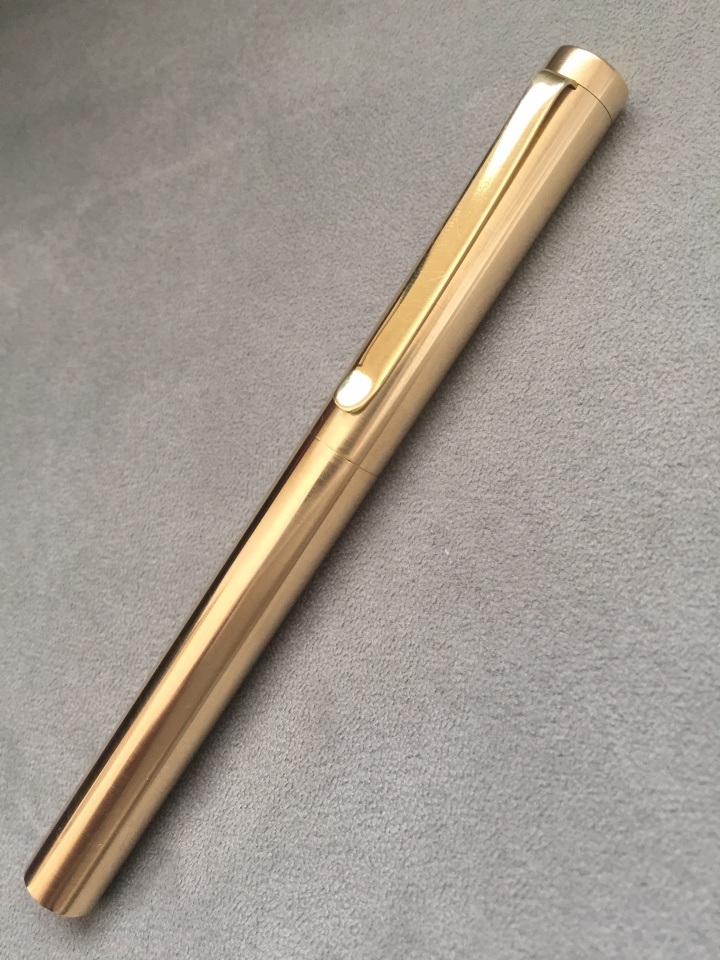

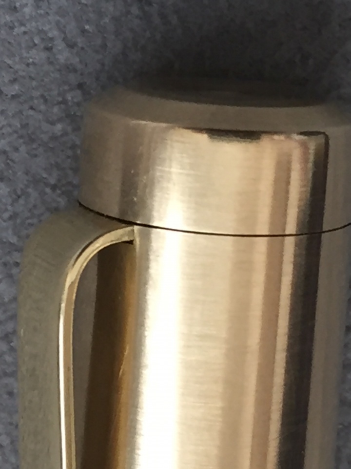

That is a hefty pen. Is that a rollstop in the top one? It is a beautiful looking trio.
You are really firing up my itch to get started on the lathe.
Before I added the clip I added the roll stop. It's a gold plated 1-72 screw. I got tired of it rolling around my desk.
