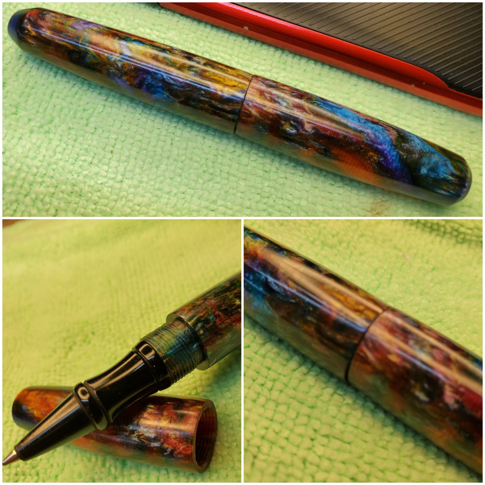

What are ways to polish/ finish the threads on a kitless pen without wearing off the threads?

I am not very experienced, but have only used Meguiars Plastic Polish and Novus 1. I also have some very fine buffing compounds that I wouldn't hesitate to use (much less aggressive than white diamond). Beautiful job on the pen ! I would love to know the thread sizes used.

By the way, welcome to IAP, Jonathan !!! . I believe this is your first post. . That is a lovely looking pen !!
Is it a rollerball ?
M13 and m10

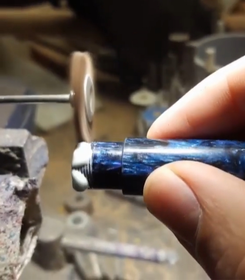

Plastic polish on a soft bristled tooth brush.

Shawn Newton has a video and some pictures of a horsehair brush attached to a rotary tool on his Instagram site. He uses some plastic polish on the threads and rotates the pen body on the horsehair brush. He cautions not to use the wheels with plastic bristles. He says he gets the brushes inexpensively on e-bay. You have to go down his page a bit before you see the brush.
