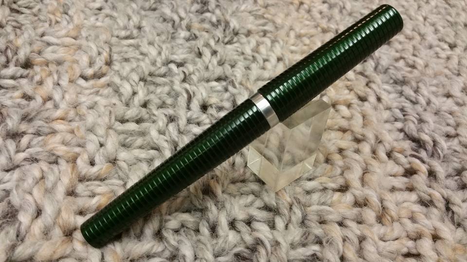

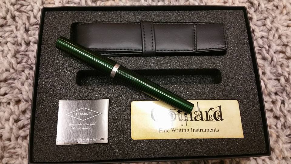

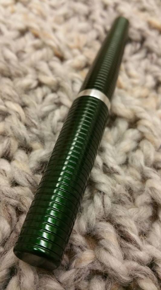

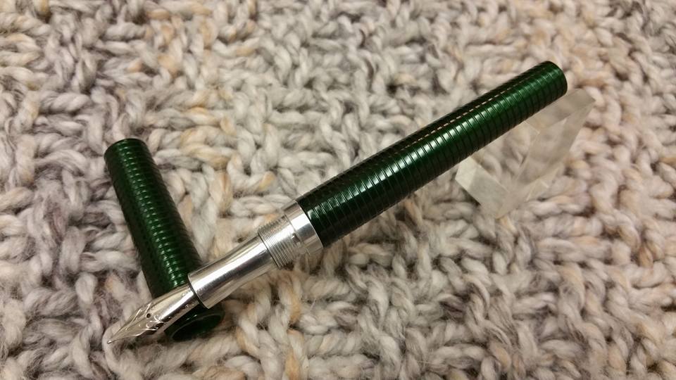

Crafted from aluminium, and anodised Dark Green. I've had to change my tactics somewhat for anodising these. closed ends proved to be troublesome! Think I've sussed it now :biggrin:
