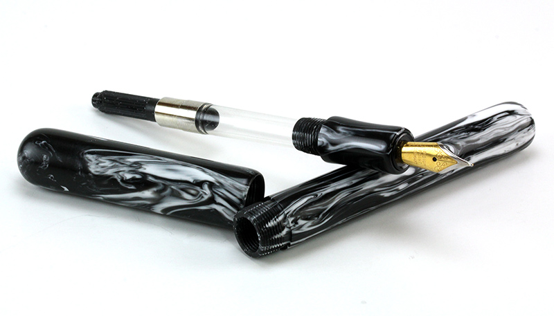

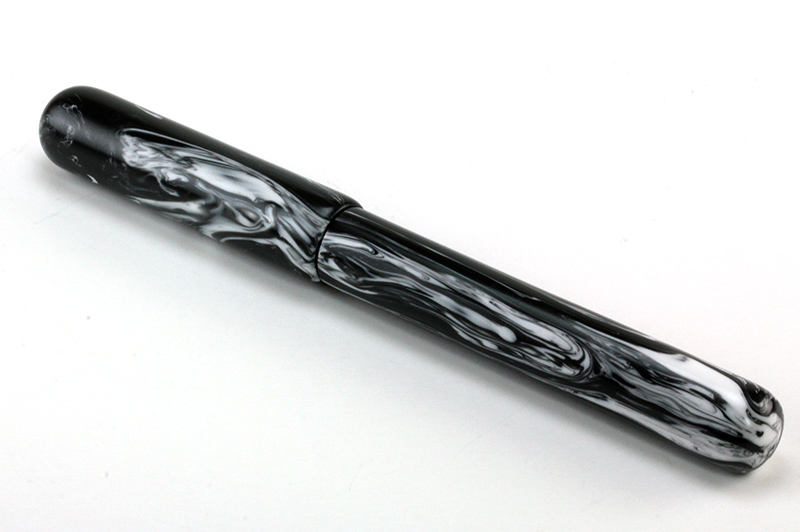

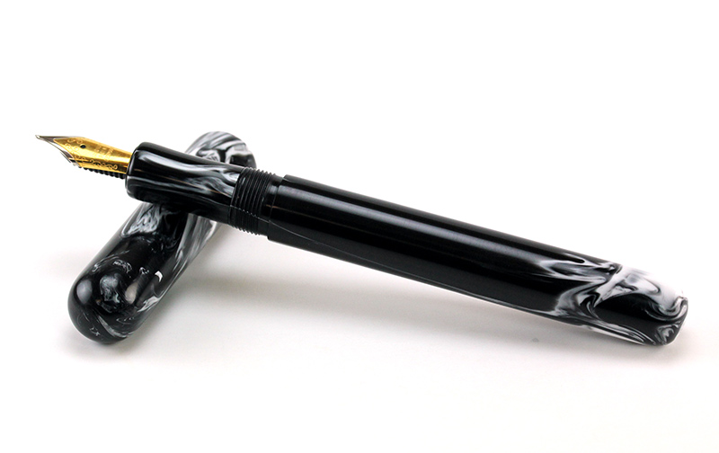

Getting a little closer to a good product. There are just a couple of issues with attempt #2. The biggest issue with this pen which will be easy to fix next time is the number of threads. This pen could cause carpal tunnel syndrome since it takes about 10 twists to screw the cap onto the body.:redface: I could probably part off about half of the threads. It is alumilite, #5 medium nib,and is about 5.35 inches long when together. Comments good or bad, thanks.

Thanks for the comments.
I could use some advice on closed end mandrels. I don't own any so I end up sanding and buffing half, take out of the beal collet, flip it around for the other half. Is there such a thing as adjustable mandrel that will work on a few inside diameters?
Mike thats a great looking pen, you are off to a good start!

Pen looks great. That's the main thing I'll be changes on my prcedure as well....lessen the number of turns on the threads.
That's a Brooks blank, isn't it?
Thanks for the great advice and comments. Just one of many values to IAP--free advice.
Chris, what a compliment thinking that is a Brooks blank. His blanks are awesome. However, That was made by me using black and white alumilite clear.
Well, in that case don't adjust your procedure! It looks great!
Very nice! Keep it up!
