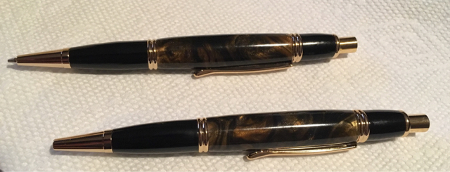

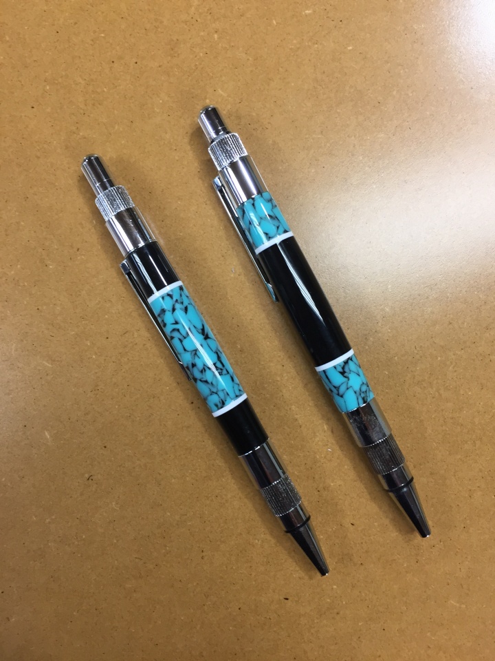

I made a Stratus pen and pencil set and I was very disappointed in the pencil.....it was more like a drafting pencil that needs to be "pointed". I gave them to my wife, she always says she loves it but I can tell, she doesn't use it. If you pull off the end cap, there is a sharpener in it. Maybe I am wrong, but I thought it was weird. Please excuse my cell phone photo......

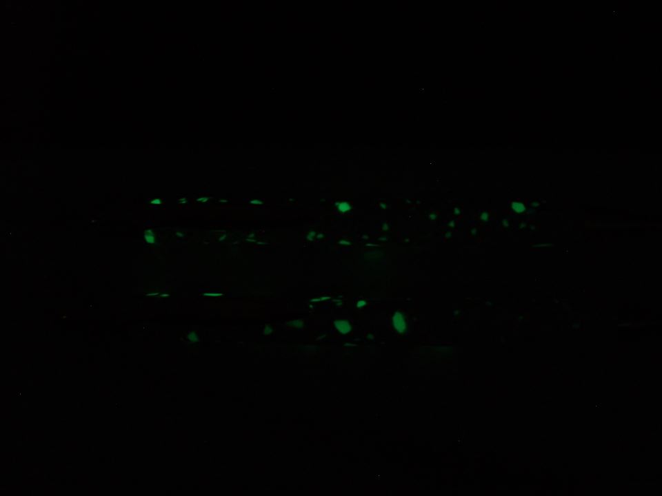

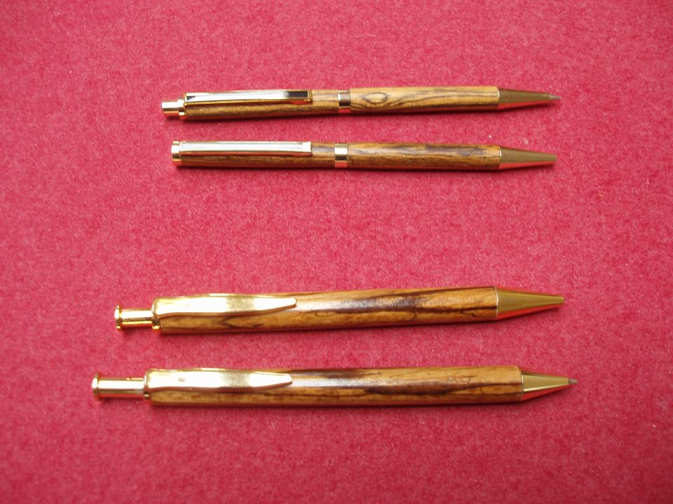

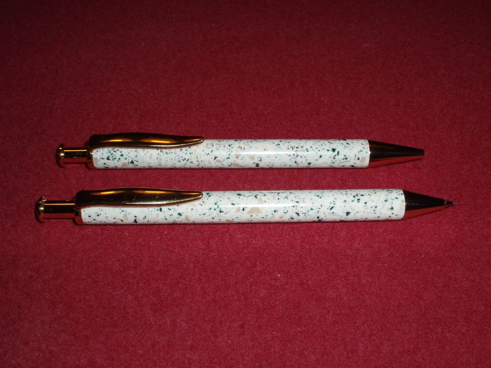

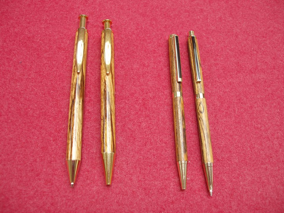

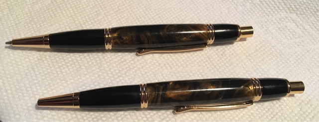

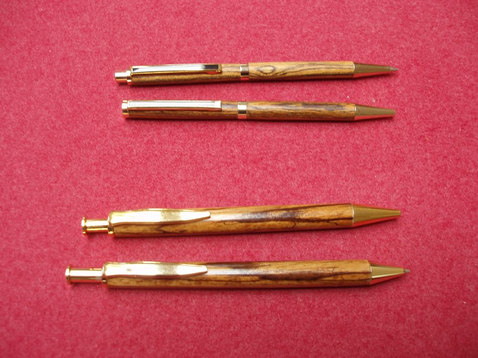

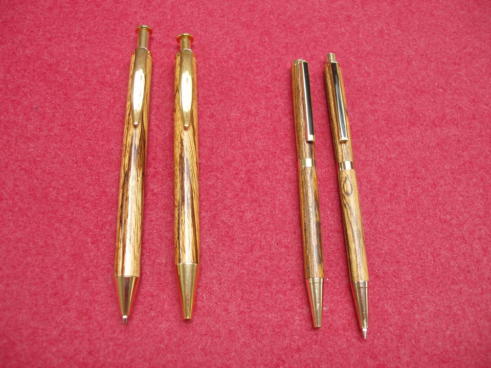

I wanted to make a few matching pen/pencil sets, and I bought them at Rockler. Here are some Rockler pen/pencil sets that I have made. The five digit numbers are Rockler's ID numbers:
Slimline Gold 61263 and 61254 (cheap, black rubs off from clip, probably Rizheng):
Twist Pen: https://www.rockler.com/slimline-pen-hardware-kit-gold
Click Pencil 0.7 mm: https://www.rockler.com/slimline-pencil-hardware-kit-gold
Slimline Gold 24k 58856 and 59107 (better quality, probably Penn State):
Twist Pen: https://www.rockler.com/slimline-pen-hardware-kit-24k-gold
Click Pencil 0.7 mm: https://www.rockler.com/slimline-click-pencil-hardware-kit-24k-gold
Long Wood Gold 46620 and 48521 (source unknown):
Click Pen: https://www.rockler.com/long-wood-click-pen-hardware-kit-gold
Click Pencil 0.7 mm: https://www.rockler.com/longwood-click-pencil-hardware-kit
The same pen and pencil kits are available in other finishes. The Long Wood click pen mechanism feels very different from the Slimline Pro click pen mechanism. The Long Wood pen requires more force and feels more "mechanical" compared with the Slimline Pro.
The photos show:
Slimline Gold Twist Pen in Bocote
Slimline Gold 24k Pencil in Bocote
Long Wood Gold Click Pen and Pencil in Zebrawood

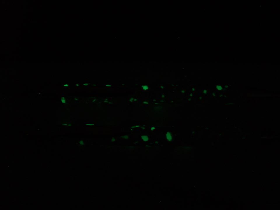

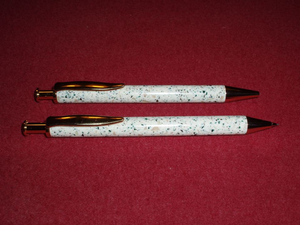

Long Wood Gold Click Pen and Pencil in "Asteroid Glow Stonez" acrylic, which glow in the dark.
Note the mismatch between the cheap Slimline "Gold" and the good "Gold 24k". The black stripes are slightly different. Dang!
I hope this helps!
