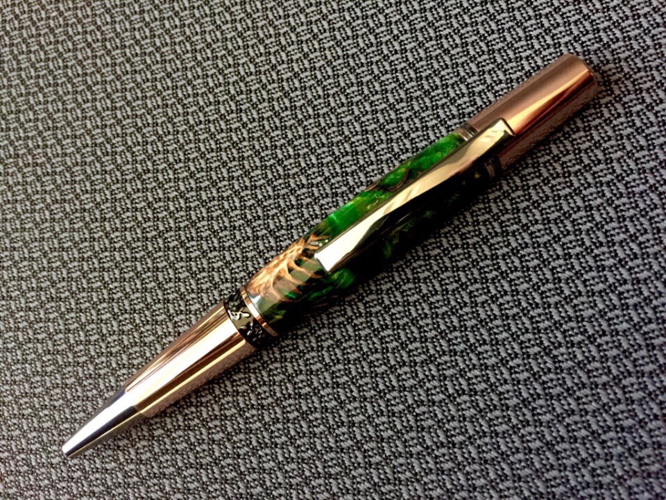

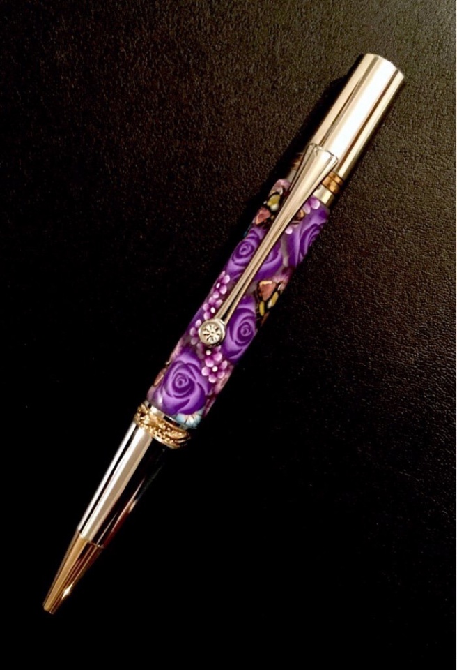

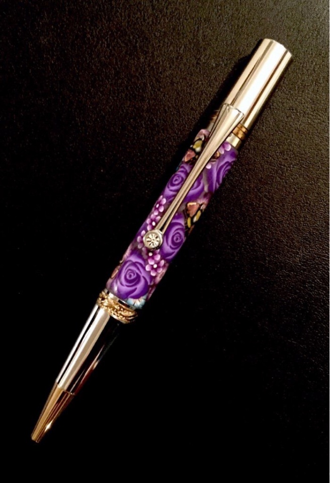

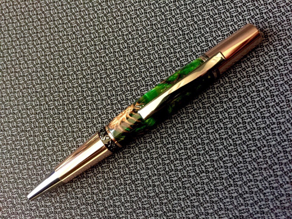

I would suggest the Aero twist ballpoint. . Small (just right for a lady's hand) and classy (elegant). . The Sierra Elegant Beauty or Elegant Sierra (two different kits) also have the "class" you are looking for but are slightly larger. . These latter two may be available as "click" ballpoints.
The options are almost endless. One thing nice the Aero it is small drill size (23/64); it is also relatively "meaty" and can use less opaque acrylics - i still paint the inside of the barrel though. The gals i give them to love them. However, you may want to spend more on it. I also had women love the cigars and tritons. I was surprised.
Majestic Squire would be my go to kit for this situation.
The Aero Twist (Elegant) would also be a good choice.
Sent from my iPad using Penturners.org mobile app
