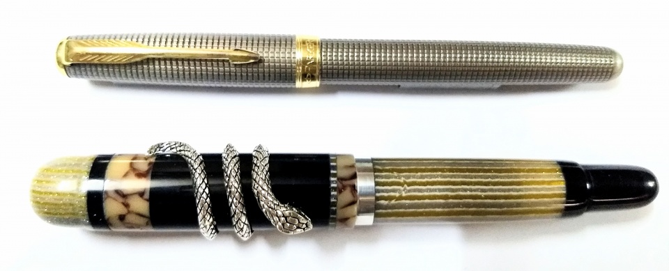

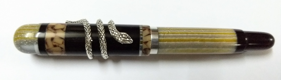

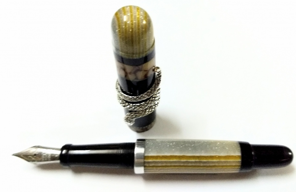

Made one pen today using leftover pieces of earlier used blanks and a five inch piece of black pmma acrylic rod.

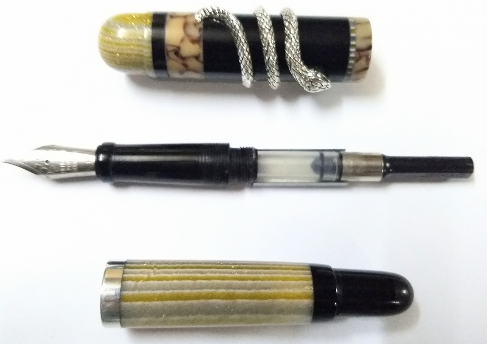

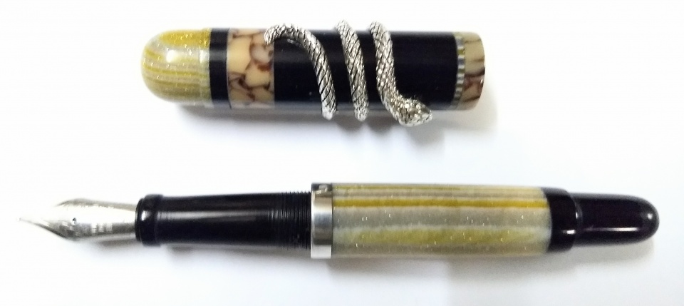

The section is made with two sets of threads, so the section attaches both with the barrel as well as the cap. The dome shape can finial can be opened and a standard clip can be fitted, however a slip on type snake clip is used here.
Jowo 6 nib unit and Jinhao converter fitted.
The long section allows good grip , and the finger does not touch the aluminium seat ring ( it's sharp edges are chamfered and polished smooth however).
The pen short in length as shown compared with a Parker Sonnet.
Hope you all like the design. Welcome comments and criticisms.

Your work is great !!
But I find the variety of blank patterns on the cap a little distracting ... the two rings of "chip" pattern look out of place.
Where do you get your snake roll stops, please.
