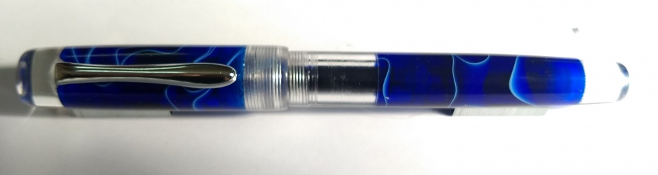

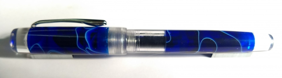

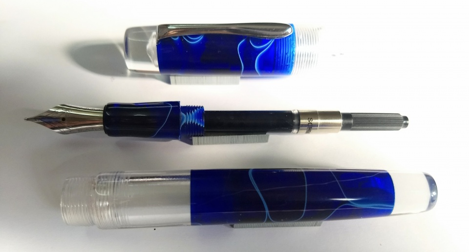

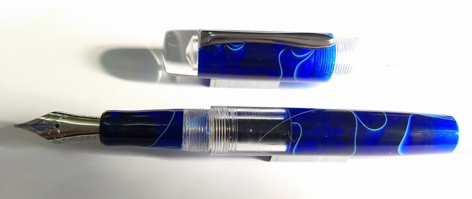

This blue pen is made from a single 5.5 inch acrylic blank and clear acrylic rod to make up for the short fall ( two blanks are needed for a kit less pen). The internal surface of the ink window can use a little more polish. Jowo 6 nib unit and Schmidt k5 converter used. Ink filled and tried out the pen, satisfactory. Hope you like the design. Welcome comments and criticism.

Beautiful work. Tell me - just how do you polish the inside of the clear? That has been a boggle and I have intentionally avoided clear for that reason. Share your process? Thanks for the pix- lovely pen!
