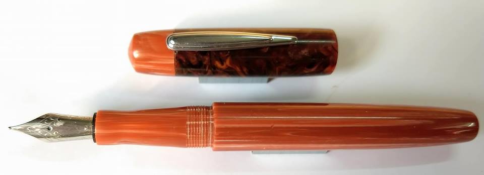

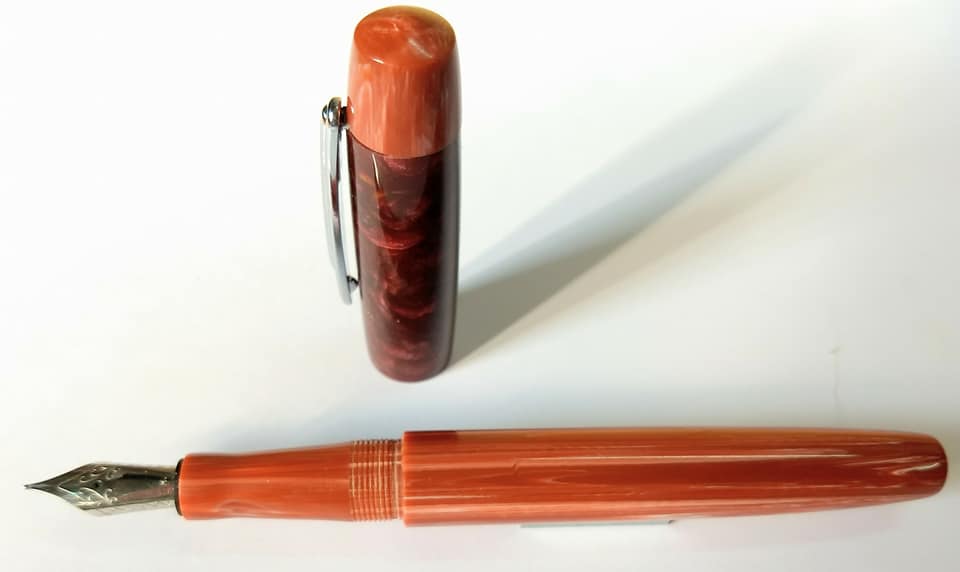

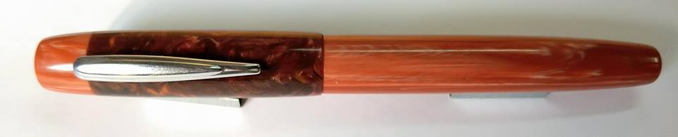

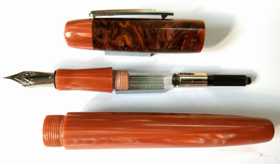

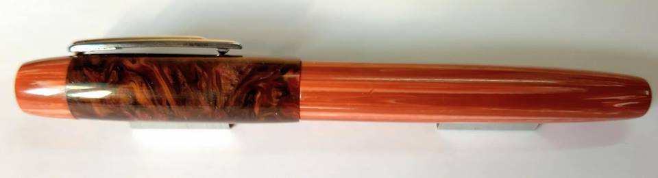

I have come back on vacation about three weeks and made a few pens that I like to share.
This is the first pen I made after coming back to Kolkata. Material is polyester resin, red coral faux stone. For cap a brown shade is chosen as the original cap broke apart. 154 mm long barrel max diameter 14.8. Cap max diameter 17.3 mm. Joyo 6 medium nib, Schmidt k5 converter. Slightly oversize pen but the clip fits into the shirt pocket.. Hope you like the design.
