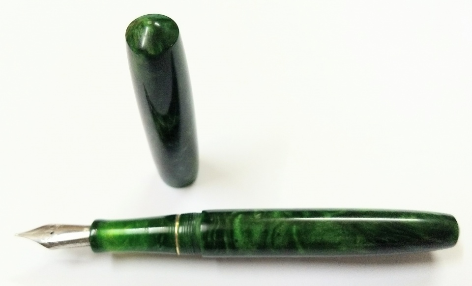

Kit-less pen in emarald green polyester.
See more from sanyalsoumitra
Apr 27, 2013
261
Kolkata

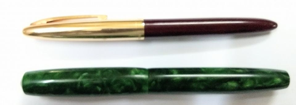

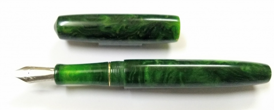

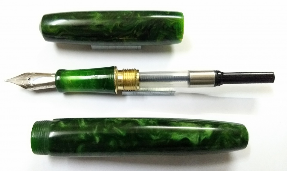

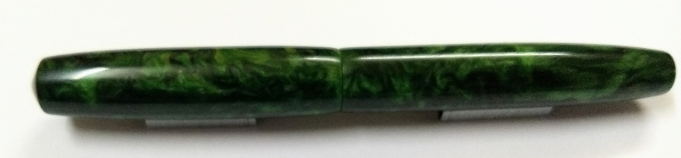

I made the first clip-less pen of this vacation last night.... as all clips have finished! Really speaking making the cap is easier on a clip-less pen. I am grudgingly beginning to like clip-less pen design..not sure if I would feel it to be a full bodied complete pen. Well, ... Clip less it is.
Faux stone emarald polyester blank, Jowo 6 nib unit and Jinhao converter. The section has a brass insert with the coupler threads.... will continue this system for a few pens now on, though some more time goes to machine the insert. ( Wish these were available to buy). The last photo with a WinSung 233 is for size comparison. Hope you like the design.

Your pens look very nice but how do you carry a pen without a clip?
In a pocket - This is my usual way for a carry pen, and some "nice" pens. Many of my carry pens are clipless modified slimlines - nothing special, other than they were a challenge to make, and I like them.
Hi Sanya (is this your proper first name and how to address? Correct me please).
This pen, as with many of your previous is wonderful.
I will suggest a modification for you to consider: I would love if you turned the middle centerband sections of both upper and lower blank for a seamless joint. Rather than the tapered effect, can you work towards a profile that includes both blanks, for a uniform joint (not necessarily unseen, but a uniform line).
This is just a thought.
I love how you have progressed the past few years! Very excellent.
Mark
