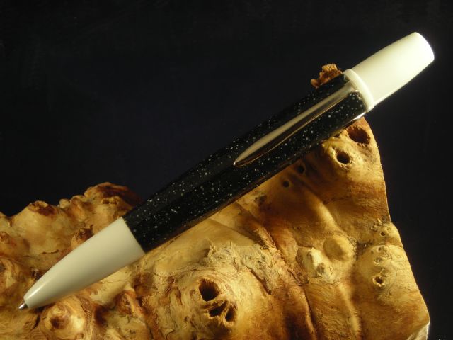

This is my latest attempt at duplicating most of the ballpoint kit pens we make . It is a Kitless Polaris . It is made from 2 7mm tubes and a slimline transmission , and a clip I bought from Elliot (xylostyle) , all of which I buy in bulk , and some Black and White Corian .
I love these Finial operated kitless pens , they are a blast to build .:biggrin:

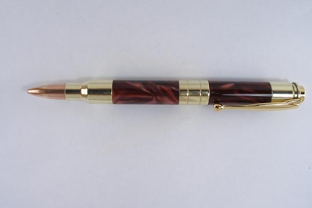

Hi All,
I wasn't sure if I should post here, but I was looking at some of the others and I read the rules and decided to enter.
I used the tubes, transmission, clip and finial from a fancy slim kit. As you can see, the nib and center band are custom made. It is wrapped in red and black marble celluloid from Woodcraft (I think).
Hope you like it,
Like it ??? .... I LOVE IT !!!
Steve that is an awesome pen . I'm not a fan of the cartridge pens but this one has "Class" . The blank gives it an elegance that regular bullet pens lack , and the CB is the perfect size to bring it all together .
Great job :good::good::good:

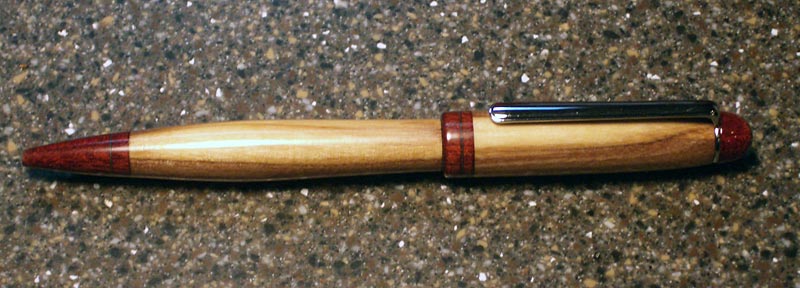

doesn't quite qualify
Here's my first completed kitless. It doesn't quite qualify because the tubes and clips are from a euro instead of a slimline. It was pretty challenging, and Butch suggested I post it in this thread as well. It is BOW and Bloodwood. The stripes on the centerband and nib are gray pearl ex. They don't show up as well in the picture, but are pretty nice in person.

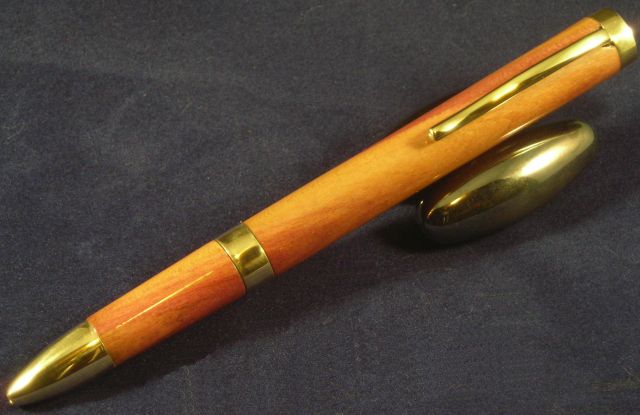

This is my newest entry here in the Challenge . It is based on the Longwood which is my favorite pen design . I have beefed up the design a bit , this pen is 1/2" in diameter and has a real nice feel to it .
It is Purple Plum wood with 3 coats of thin CA as a sealer and 6 coats of Fast drying Poly .
The picture don't show the beautiful coloration of this wood , there are subtle tones of pink and red in the grain . I just wish I had more of this wood .
It uses a 7mm transmission and tubes with polished brass for the kit parts . Using Brass and Aluminum for these kitless designs has added a bit of elegance to them , and has opened up several new design possibilities which I will be showing soon .

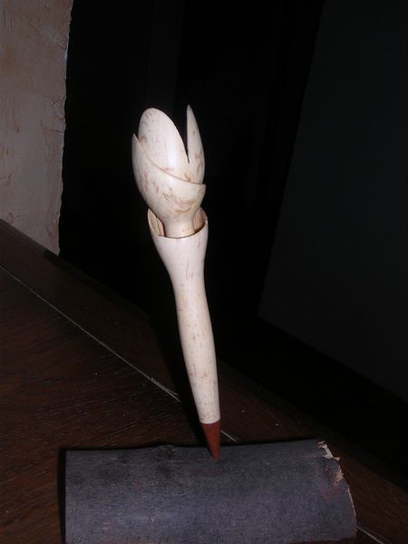

kitless flower pen

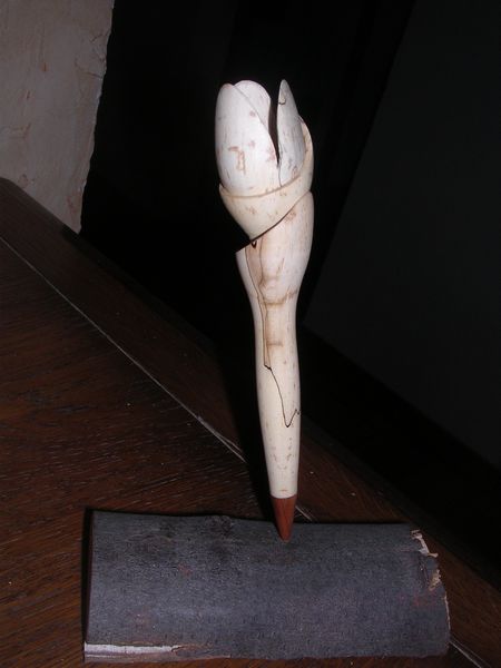

A Chritmas flower for the wife of our heart.
He is made with spalted "castanea sativa" and "prunus domestica"
Only with tubes & transmission of an old slimline
As always, comments and suggestions are appreciated!

WOW! very creative. I even like the looks of it which is hard to do with me. I don't take to different very well. very nice work.

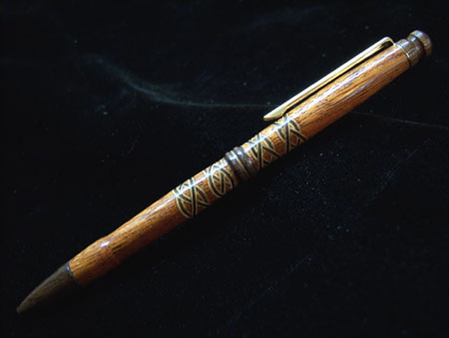

Ok, here it is. My first ever kitless pen. Yes, it is far from perfect, but, I really enjoyed making it. I have followed the rules. The pen twists closed and the upper body comes off to change the refill. This pen is made of Mahogany, Walnut and Veneer. I may change the clip out yet. Thanks for the challenge. Thanks for looking.

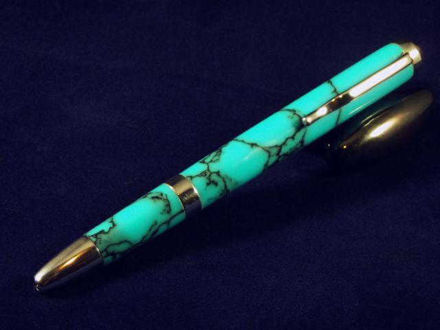

This is my next entry , it is a Blue Turquoise Kitless pen . It's another in my Calypso line of pens . It is made from some Blue Turquoise Tru-stone and Aluminum bar stock and uses 2 7mm tubes and a 7mm transmission with a custom Aluminum clip .

Gee, Butch, somehow I missed your post of the tru-stone one. I really like that. I have got to get brave and try turning some soft metal. I only have the Harbor Freight set of turning tools and don't know it they will hold up to it. They do fine on wood.
Paul , I don't think you will have any problems with those tools (they are the better set ? M2 steel?) if you take it easy and don't get too aggressive . You will have to sharpen them more often but they will work .
I think you would be better off trying brass first , it turns better then aluminum . Get C 360 free machining brass or if you want to try the aluminum then get the T 6061 type aluminum which is the most machinable .
Just remember that metal won't chip or break the way wood and plastic do when you get a catch so keep your tool rest up nice and tight to your workpiece so your tools have a very small overhang and hold on tightly .
For around $30 to $40 you can get the carbide tipped set of tools from PSI (Amazon is cheapest when they have them) , they hold up real well and stay sharp for quite awhile . This set works great for Tru stone and other hard materials and you don't have to keep resharpening them every 5 minutes .

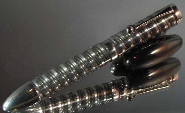

Here is a fountain pen. All parts made by me except the nib. 4 start thread done on the mill. Two views of pen and one of small diamond on the cap. Made from tortoise shell acrylic.
