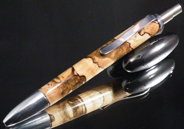

Thats the ones I use for these pens , this is my Telesto line of pens .
I love those mechanisms , they are silky smooth but they are slimline sized so to use it on anything bigger you have to figure out some sort of coupler to transition to the body size . He lists the tap size needed in the ad , I'm not in the shop right now but I think it was 7mm X 1 or .75 .
