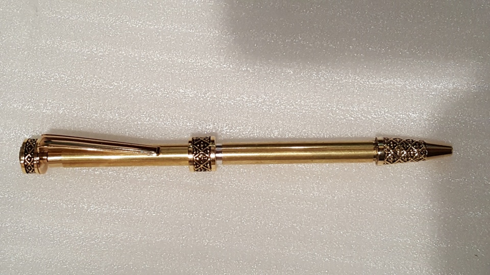

Hi all
I have to offer these kits, that came in a bundle I picked up. They were in a bag with a set of bushings, that don't match any of the components, other than the tubeshow which are 8mm.
It appears to need to have the blank turned down to the brass, where the center band goes on.
Any help would be appreciated.
Thank you very much. Thats exactly it.
The bushings that I got with he kits are for the classic twist. While they look the same, the dimensions are all different. I'll use them to get close, then go between centers. I was most interested in the instructions, to find out about the tenon.

Sculptured Twist BP
Category = Ornate Medium Sized BP Pens
Style = 2: Two Blank Pen
Tubes = PKT8-8
Bushings = PKSCBU
Upper Tube/Cap:
A Drill Dia = 8mm or O
B Tube Dia = 0.311
C Length = 2.00
Upper Bushings:
D Bushing Dia = 0.480
E Bushing Dia = 0.286
F Bushing Dia = 0.480
Lower Tube/Cap:
G Drill Dia = 8mm or O
H Tube Dia = 0.311
I Length = 2.00
Lower Bushings:
J BushingD ia = 0.393
K Bushing Dia = 0.286
L Bushing Dia = 0.393
Information provided courtesy of the IAP Bushings and Tubes app
Here are the pen instructions.
