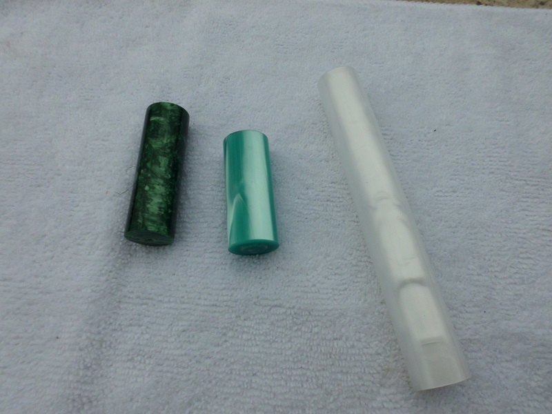

attachment.php
From left to right ...
Kirinite Green Ice
Kirinite Turquoise
Lucite Pearl Drops
Forgive the slightly low image quality ... the sun just isn't out. :p Took pic outside just now, but it's overcast.

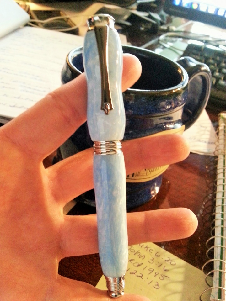

Hi Michael. I turned my first Kirinite Sky Bly Ice on Sunday (Virage - Exotics B.) . Here's a quick pic.
I sanded dry to 2000 (no MM), then buffing wheels. I examined it under a 20x loop and couldn't see any flaws (there is one that is not part of the finish or the fit ...can you all find it?)
I found it easier to turn than AA..unless it is AA, then I maybe it was the color, pressure, who knows.
I used my HSS roughing gouge except for the final cuts near the h/w. I may have just gotten lucky. As you can see I copied the design from someone here. The top should have been made more narrow (but that is not the flaw that I am talking about).
Anyway, keep at it...it may have been a poorly formed blank.
The only flaw I see is the coffee cup isn't full...
