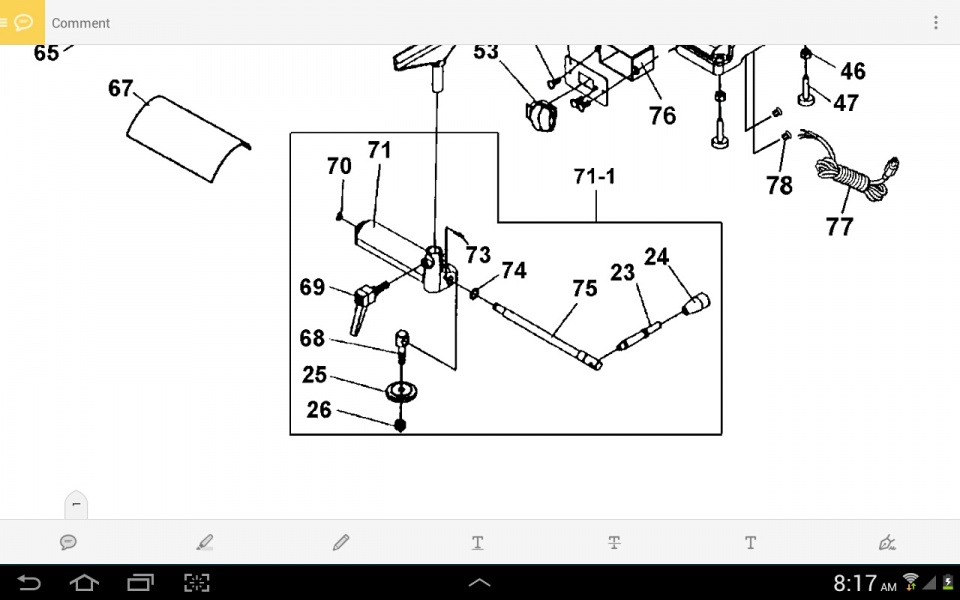

I was just not able to find how to move the tool rest base front to back. It goes left-right, but the only way I was able to approach the tool rest to the wood pieces, is by moving and turning the tool rest bar left or right.

Loosening the nut slightly should make it possible to move the banjo more freely. However, you have to be careful to not loosen it too much or the banjo won't lock down to the ways.

I have added a snap shot of the tool rest part of the diagram. You need to remove the tool rest from the lathe and look underneath. There is a rod (item 75) that passes through a bolt (item 68). The rod needs to pass freely through the bolt for forward and backward movement. Maybe there is a burr jamming it up.
I hope this helps.

I found the solution. The iron rod needed to be in a specific position between the lock and the free position and it works! Thanks a lot for your help!
