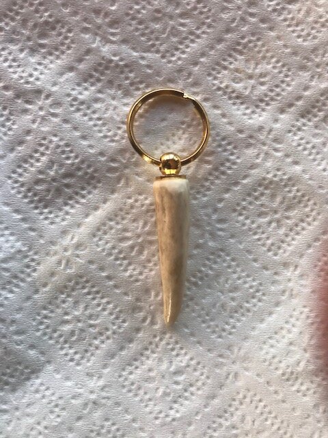

Anyone know where to get a key ring with a
post to insert into something like this?
I believe the key ring kit from PSI has a push in ring attachment. You'd need to drill a small 7mm hole in the antler top and glue in a small brass tube but that should do the trick for you. The kits are pretty cheap too and others, like EB carry them. Good luck.
