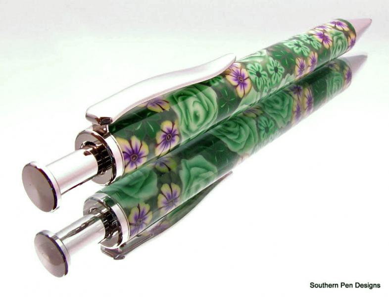

This is another tube my wife made for me to put on a long click. It has green roses four leaf clovers and hibiscus flowers. The pen is a Rhodium long click from LauLau and has around 10 layers CA sanded through 9 colored pads and polished with Novus.
Thanks for looking comments welcome.
Sorry about the pink tint, I do not know why it happened. I tried everything to get rid of it.

What a great looking pen!!! I just sold 2 pens like that this weekend. Your pen is beautiful but how did you photograph it? Can you give us your secrete? Spectacular job on both pen and picture.
As you can see in the picture there is a lot of pink hue that I could not get rid of but the pen is just photographed in a homemade light box with a shop light with 60W bulbs on each side of the front of the box. The camera is on a tripod set on custom and macro and the pen is on a 1ft square mirror from Hobby Lobby. Any adjustments in the picture are done with Picasa.

The red tint is most likely color balance off due to light temperature or it's some layer mask in post processing, perhaps a warm filter of some sorts.
I just happened to look over at one of the bulbs for lighting last night and there is a pink color to it which leads me to believe it is from the bulbs I am using.

Probably the pink hue is from the auto color balance trying to get rid of the green in the roses.
I played with it a bit in Photoshop, does this look closer to what you were going for?

YAH! the pink is gone! I sure wish I could do that with picasa. Is it simple to do in photo shop? and how much does this program cost for the poor man?
Oh, Photoshop is not cheap! Maybe you can find an older version you can buy from an individual, but I don't know if Adobe would activate it.
First I used the highlight/shadow correction and brought the highlight tones down a bit, because the color correction lightens the details too much when taking the pink out. Then I used the color correction control, which has separate corrections for highlights, midtones and shadows. I didn't mess with the shadows any. Hope this helps some.

Why 10 coats of CA and then sand away 9? Why not 4 and sand away 3?
Not being funny, just don't understand the process of 10 just to take most of it away. Thanks Dave
First of all, it does not matter how many coats or how thick the CA is. The purpose is to not sand back through to the material you have covered with CA.
I did not take 9 layers off, I used the 9 micro mesh pads that get finer and finer to polish the CA.
