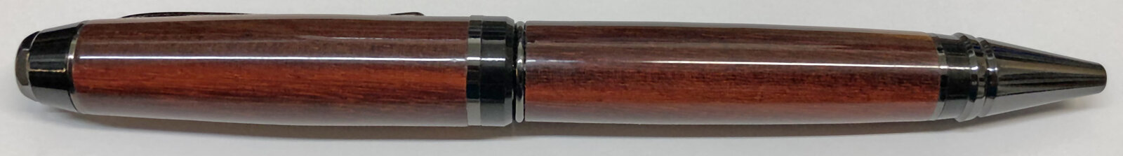

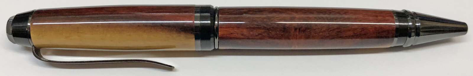

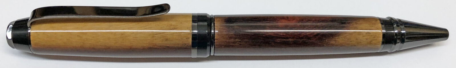

I made a Gunmetal Cigar pen today using some Mexican Royal Ebony (Katalox) that I cut up for blanks. About half of the wood was a mix of sapwood and heartwood. There is a really nice grain pattern around a knot that shows up in the middle picture as kind of a light spot. I tried to zoom in on it, but unfortunately, the camera I'm using just doesn't have the pixel resolution to do the grain pattern justice nor the depth of field needed for focusing closer to the subject. For some reason this pen doesn't look nearly as glossy in the pictures as it really is either. I'm happy with the pen, but not so happy with my photography job on this one.
Regards,
Dave
(Three Views of the Same Pen)

On my screen the photos are excellent. The pens... Superb! I love the colors and your fit and finish are excellent.
Ver nice and thanks for sharing - these are really colorful. đź‘Ť

Gorgeous workmanship, David !!! Thanks for showing !
And the colors, all in that one pen, are remarkable !!!

Nice pen, Dave.
I like the timber, the kit, the gunmetal, the finish. Super job and I see nothing wrong at all with the photography.
It is nice to see a timber pen as opposed to all the acrylic ones. ( just me )

Good looking pen, the wood and fittings really compliment each other! I bought some Katalox recently but only a couple of pieces have any sapwood.

2,701
North Carolina, USA
Can't recall seeing Katalox that light in color. I often have trouble showing off the grain in pictures since it's usually so dark. The sapwood really adds some nice visual interest to this. I guess it must be a more gradual change between the heartwood and sapwood with Katalox.
