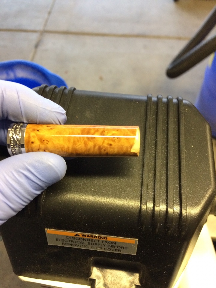

I was making a Majestic Jr with brown mallee burl as a gift and disaster struck. I was pressing the centerband assembly in and this happened. I spent several hours on this because I'm still new and have to go slow. Needless to say it was a bit of a letdown. If there's any saving grace it's that I was able to get the assembly out unharmed with flat punches and I have another blank from the same batch so I don't think I'll have to redo the lower barrel. I can also put a bevel on the next like it's supposed to have. I don't like bevels but didn't realize the bushings for the short barrel are a few hundreths different until it was too late. I wasn't torqueing it down at all. I'll admit my mistakes but I'm blaming this on the cupped end of my Penultimate pen press. The walls are thin and I think the cupped shape put too much pressure on the wood vs a flat piece butting up against it. I don't care for it at all, but it was a lot cheaper than a real pen press. To add insult to injury I thought of using a quick grip clamp afterwards. I should've known better than to buy it based solely on the name. It's a play on words but penultimate means second to last...

Looks like a beautiful mallee burl ... looks somewhat fragile also ... a letdown for you to have that happen.
I am unclear as to what you mean by a bevel. . I have adopted the practice of reaming out the brass tubes a little bit (perhaps 3 thou) and then gluing in the hardware pieces.
Ouch , I feel your pain , that looks like a beautifully turned and finished barrel . I've had a few crack when I pressed them together , using a k-body parallel clamp instead of the Milescraft press I have sitting in the box unused .

You may be able to put an OOPS band on it. Score with a skew, then turn off the damaged part. Drill a small cut-off from another pen blank(red would look nice!), and glue onto the top of the blank. Re-finish the blank.

Hard to see the detail, but looks like the tube is adhesive starved at the chip out. Glue coverage is most important at the ends with thin walls and burls. Less critical in the middle with more thickness and support.

The bushings are slightly different in diameter, so the barrel should have a slight curve to it instead of the almost unnoticeable taper.
Hard to tell in the pic but there is dried adhesive on the brass tube. I really load up the epoxy when using a burl.
This wasn't the side that had anything being pressed into either, which really annoyed me. The taper on the cup of the press has caused issues before, I'll be replacing it very soon.
