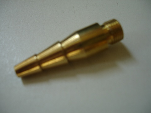

Ok, I don't have a slim nib in 10k or 24k, I mic'd them all and they are all euro's. I do have something better, more work for you but more work usually makes a better product. I know this picture sucks, but it's good enough. This is a brass hose fitting from god knows what, that I've been planning forever to do something with. I mic'd the threaded ends and inside a 7mm tube. The threads can be filed off and the end filed down enough to squeeze into a 7mm tube without compromising the fitting. The ridges can be ground down, filed, cut off whatever, even the flat spot up top has plenty of meat for shaping and it already has a small hole in it. I will send it to you for free if you are going to use it for this pen, otherwise I'm keeping it. Doesn't even need a padded envelop, it can handle a beating no problem. Looks like gold as brass does, but won't wear from use!
PM your address if you need it.

The problem with the brass is the color will not be the same as the gold of the Waterman cap, and this cap has a LOT of gold showing!
BTW, if you have a smooth 7mm nib for a Euro, that will work just fine too. 10k is best, but 24k will work just fine. My main thing is to fit a smooth nib on the pen as the pencil has a smooth shape now and I want to stay as close to the ball-point / pencil design of the Waterman's set as I can.
