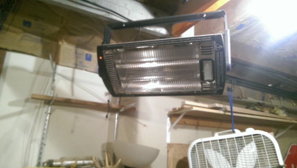

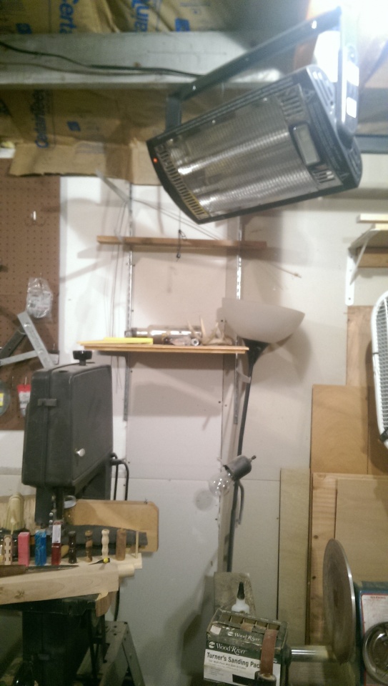

heater
I bought a ceiling electric heater that has 750 and 1500 Watt settings. (49.99 at menards) I am able to run my lathe with the heater on medium but not on high or else the breaker in the basement main electrical box in the house trips which means I have to walk 75 feet then downstairs to flip the breaker and come back out. But it's working out well I get to the shop heated before I need to go out there and then turn it off while I use my big tools.
I also just found out I can not have the heater on high and all of my lights on or the breaker trips. I know this is an issue that needs to be fixed, but for right now I need to make it through the winner on the current electrical system no matter how bad it sucks.

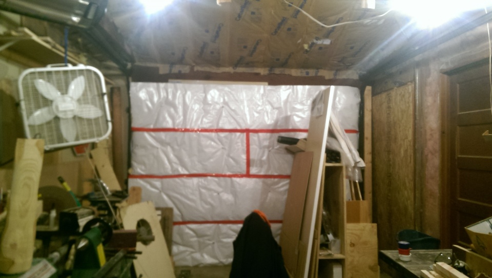

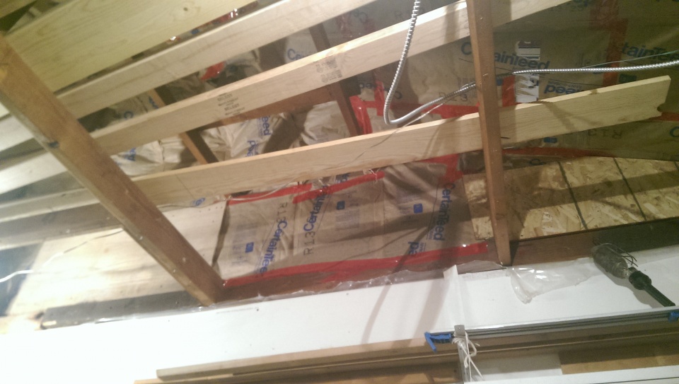

I put two pictures of the heater. the heater does not have a fan so I have one behind it blowing air.I also put a picture of the recently insulated garage door with R8 installation. in the last picture you can see the insulation on the ceiling as well as two wooden insert doors that are insulated to give me access to storage above the three season porch on the other side of the wall.
so far I can get the shop heated to 60 degrees and even when it goes down to 30 or below in the morning outside when I come out to the shop 7 hours later it is still 50 or higher. So I'm very happy so far with my heat retention. I am thinking of putting in a ceiling fan, I have an extra one laying around, to help the heat get pushed down to the rest of my shop.

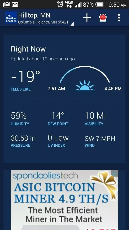

Happy with my insulation project!
Outside at 11am. -19 (wind chill) inside my shop with heater on... 53!
