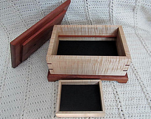

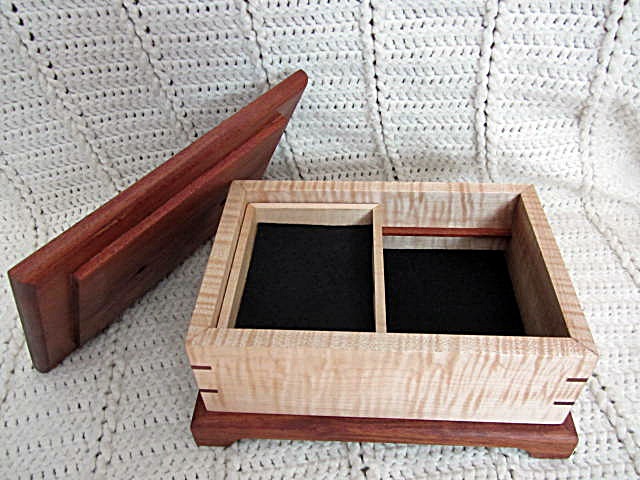

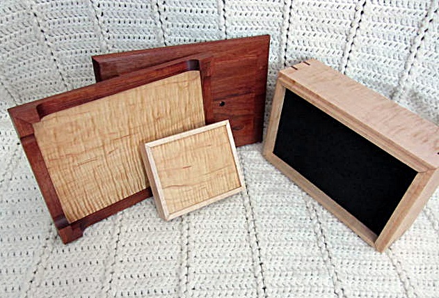

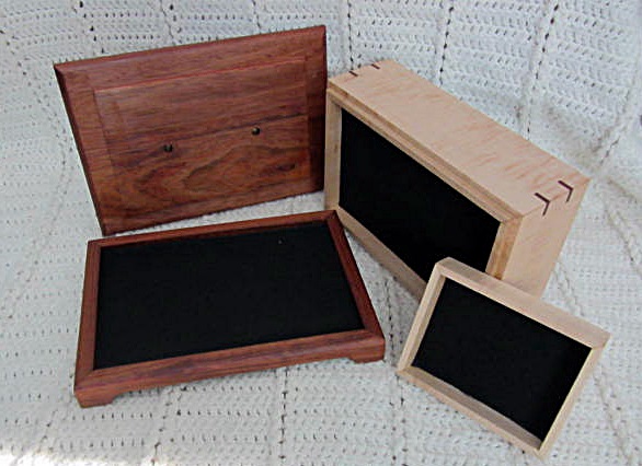

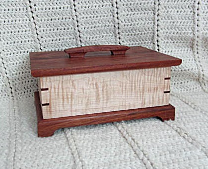

I wanted to make a gift for my Granddaughter to take when we go visit in a couple weeks. Decided on a jewelry box or catch-all box. I've never made a box like this before, so it was a fun adventure. The box (curly maple) portion lifts out of the bottom trim to give access to a "secret" compartment. Not really very secret. Anyway, it is curly maple and a rosewood. C & C appreciated.

Thank you all for the nice comments. The plans came from the Wood Magazine site, cost $4.50. I was surprised, they were well done plans and I followed pretty much set by set. The only problem I had was I think there is an error in their measurements for the very bottom piece. I cut the 1/8" hardboard to their measurements and it was too big. I double checked and triple checked my measurement and all other measurements matched the plans, so I think it was an error in the plans. It was an easy adjustment. I did build my handle different than what the plans call for, Theirs was a solid piece and I didn't care for the look of it.

Really nice, I love the contrast between the woods, and the figure on the maple looks very nice. The chatoyence looks very bright- what type of finish did you use to get the figure to show so well?
I use 100% Pure Tung oil, First two coats I thinned it to about 50x50 with mineral spirits then two more coat of just tung oil.
