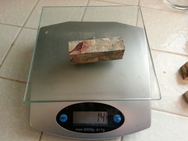

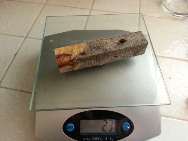

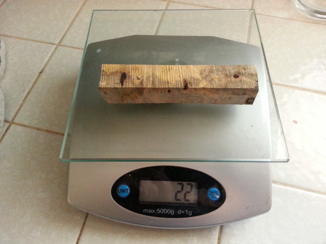

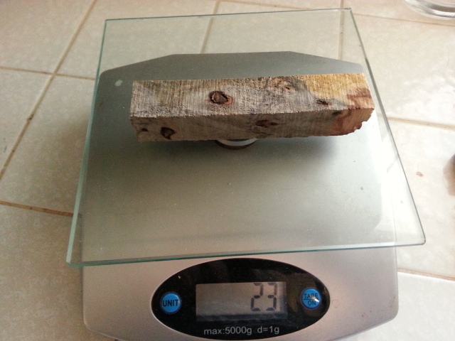

Ed asked if I'd done a weight pre/post on the buckeye burl. I hadn't...but neither had I finished them all! I had 4 left so here are the dimensions and weights of the blanks pre and post:
Blank 1 - start wt 23g, finish 49g dimensions 7/8 x 7/8 x 4.5
Blank 2 - 14g, 30g, 3/4 x 13/16 x 2.125
Blank 3 - 23g, 53g, 7/8 x 7/8 x 4.5
Blank 4 - 22g, 41g, 13/16 x 3/4 x 4.5
You can see a dramatic gain in weight!!! At least double in all but one blank. I have measured in oz before, but since pen blanks are small, I changed to grams so a difference can be noted.

blank #4 is approx 6g shy of where it should be. 6g sounds light but put into perspective that's 2.21g per cubic inch. It is also likely that blank #4 contains more heartwood and much more dense than blank 1,2 and 3. Even then that does not fully equate to the shift we see in blank #3 so like it's more than just heartwood at play.
Also Blank #3 soaked up more resin than the rest so that blank will turn slightly different than blank 1 and 2 but not that far different. Going out on a limb here blank #3 likely has some softer spots that are less dense than what blank #1 and #2 has internally, things like sapwood perhaps.
Could very well be...especially #4. Overall, very happy with how they came out. I have plenty more to do so I'll keep making notes.
In fact I do!! I have the "before" shots when I weighed them. I have to email them to myself from my phone then I can post them.
These are the before pics on the scale.
