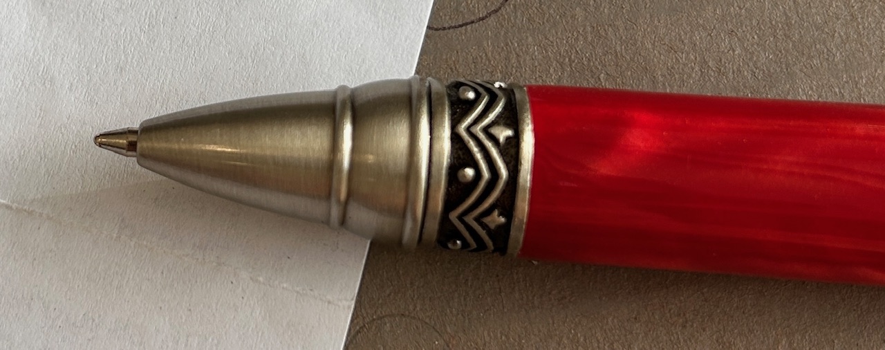

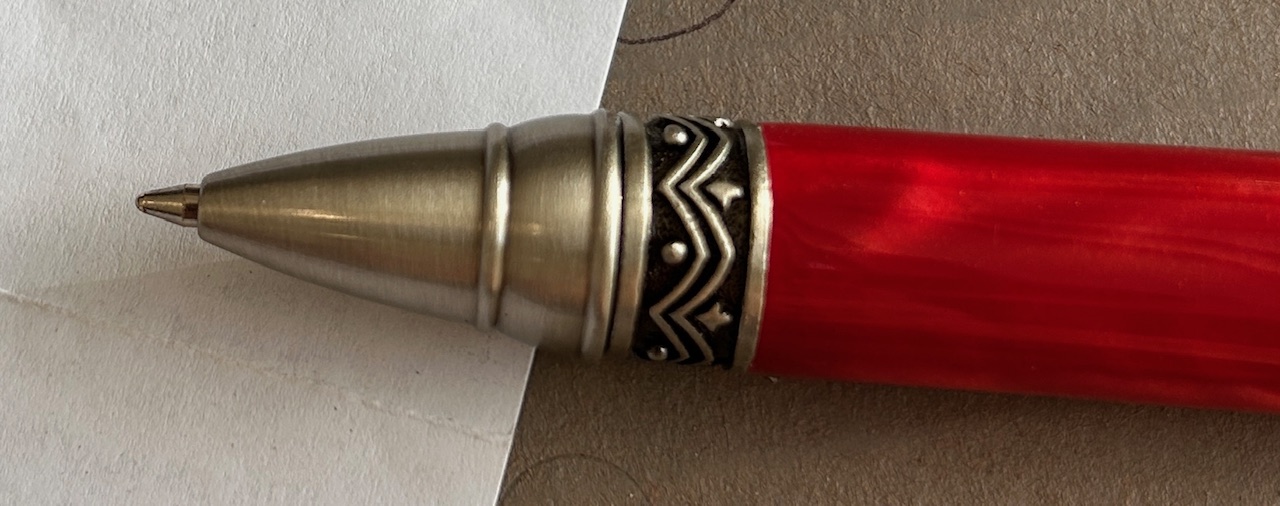

We try our best to make each item a showpiece regardless if it's for sale or a free gift. Just how we are. Do it right. However not everything comes out right and if it's for sale it's not getting sold. I made nice pen for a gift...the tip would look better if it came out a little more. I'm tempted to disassemble the shorten the blank a little... and then WTH... it's a freebie why tamper with the possibility of ruining it. The question...how far do you go..or stop.

It all depends. At times we are our own worse critics so the fix you propose will it solve the problem as you said? Is there another way like adding a piece inside the cap to extend the refill?

Yes...to adding. And if a touch too long I'll sand off the little nib on the refill end ...and I'll explain that to the recipient.

I have permanently extended the plunger/twist with UV resin. Works great! I have also shortened the plunger/twist slightly.
Are you inserting a trimmed piece or can it be fixed/attached to the plunger somehow? I have the white extensions but cannot trim a tiny piece from it.

I add it to the metal plunger end of a schmidt click or the plastic or brass twist end od a twist mechanism. I use Solarez thin hard formula with their blue light/torch. i place a dot on top of the plunger, cure test, snd sand or grind to the right height.

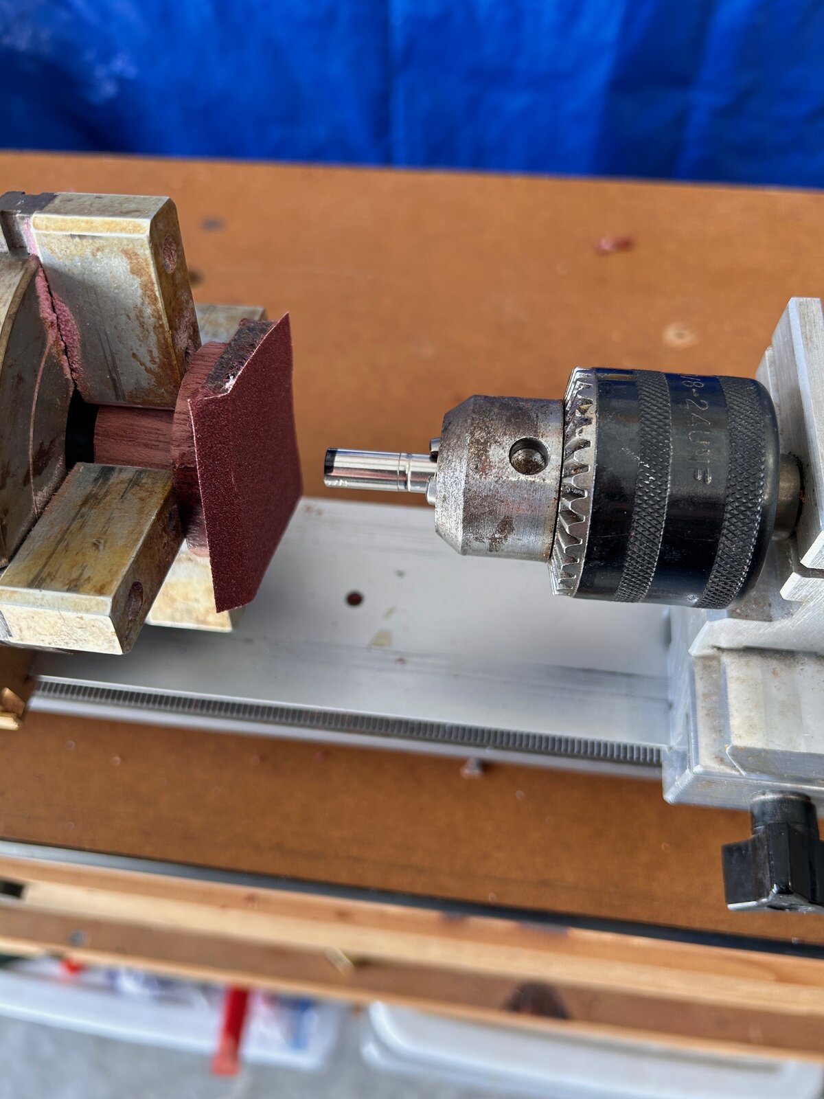

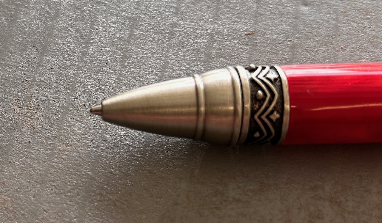

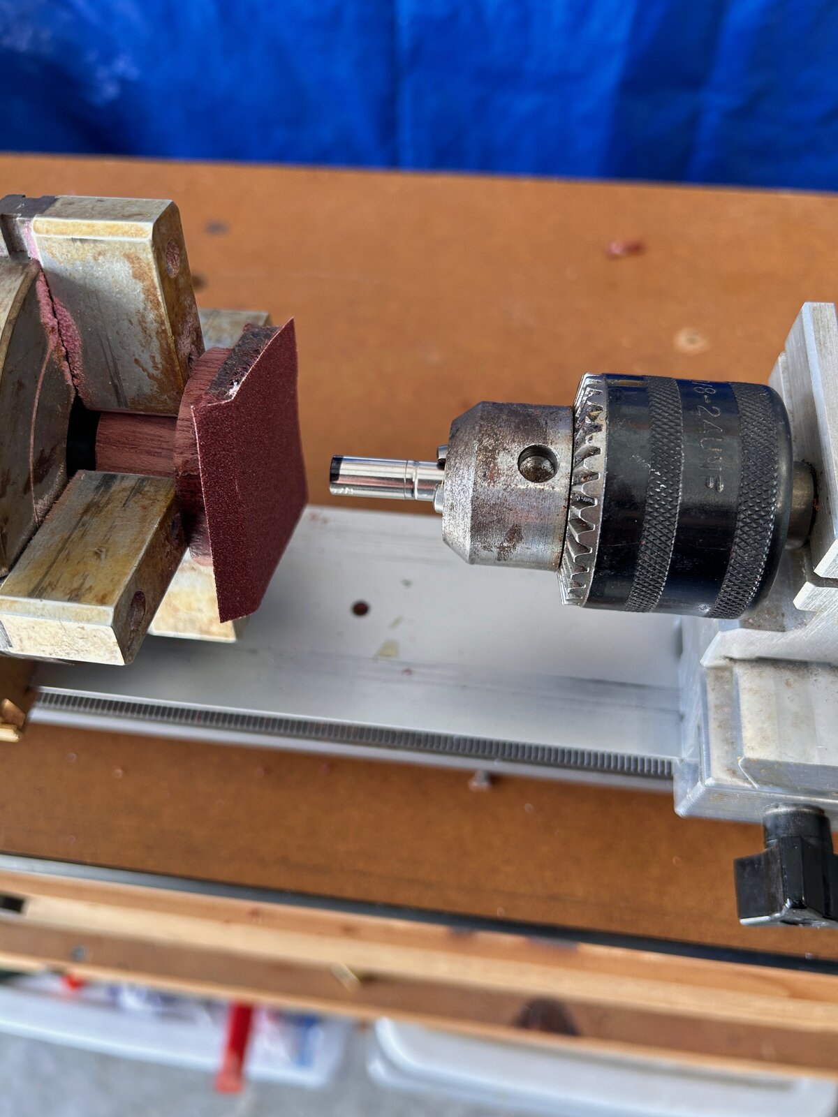

Needed more tip. Thought the chuck/sanding disc might work but the twist kept slipping. I did not want to make the jaws any tighter so I hand held the twist and knocked off a tad. Worked liked a champ instead of shortening the blank or trying to extend the refill.

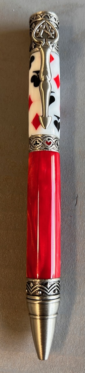

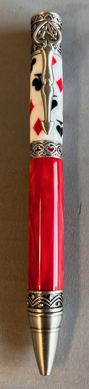

And another oops moment...top segment is upside down. (I'm losing it folks😂).. Still going with it. It's now a rare 1 off...I'm on a billiard forum ... a moderator/member held a drawing for 2 items . Mine is one of them. 100% of the proceeds went to a charity/ foundation that helps people in need from last 2 hurricanes.
