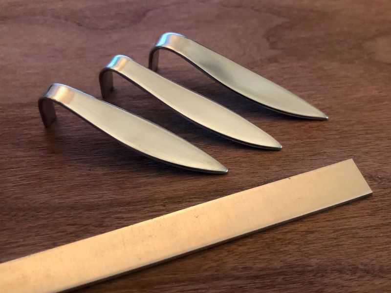

I just finished making these three clips from Argentium silver. The raw material is that strip in front of them.
220215
It was relatively easy to work and is able to be hardened (I'm sure that's relative too). It resists tarnish and is even purer in silver than sterling (.935 vs .925). I am hoping to install these on some of my pens soon to take them for a real world spin.

Cool, thanks. How did you harden it?
Thanks
In line with some of the videos on the subject I saw, I shaped the clip to the form I wanted and then basically baked it as high as my toaster oven would go (500-550F) for 1.5-2 hours. I then polished (polishing doesn't work well when dead soft). That's basically all that's needed. I don't believe sterling silver is even capable of being hardened, so I think the Argentium is a good choice.
I tested the spring after it was hardened and there's a decent amount there. I don't think I'd advise an owner of one of my pens to purposefully lift the clip far beyond its intended range, but it's definitely as firm as I think it needs to be.
