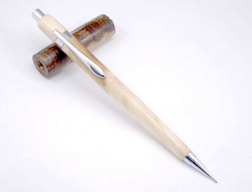

Very nice what material is the blank? Is it timber? Which one? Looks great, suits the one. Like the shape too

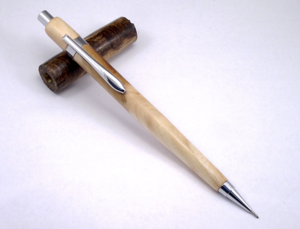

Yes, it's timber. I think it's a piece of Hobhornbeam -- a prevalent species here in middle Tennessee. It's a light colored wood similar to Boxelder and Hackberry, but a bit more dense. Here's a darker shot showing the wood grain a little better.
I'm having trouble finding that particular pencil as I look online. I got a six-pack of them at OfficeDepot a few months back for, as I recall, about $5. The 0.7mm pencils I'm seeing now have the clip molded into the top of pencil.

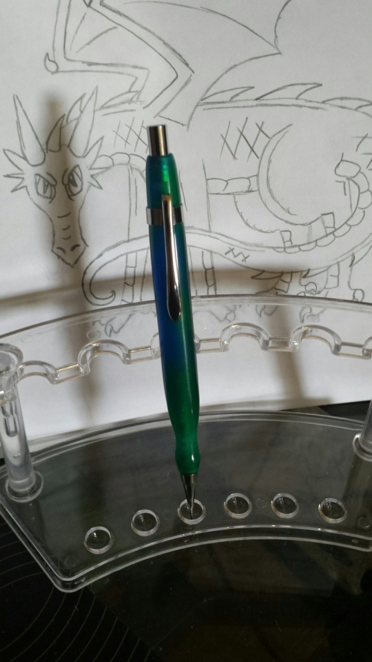

They have to get past the dragon....
I'll do whatever it takes to make a profit.
This one didn't turn out it's a tad small at the bottom. I did it to prove I could make one.
What do you think it's worth? Foray pencil guts, and a home made PR blank...

$25-30 easy. The price of the components is irrelevant. You've got at least a couple hours labor in that, to say nothing of the art. My customers aren't just buying cheap pencils.
