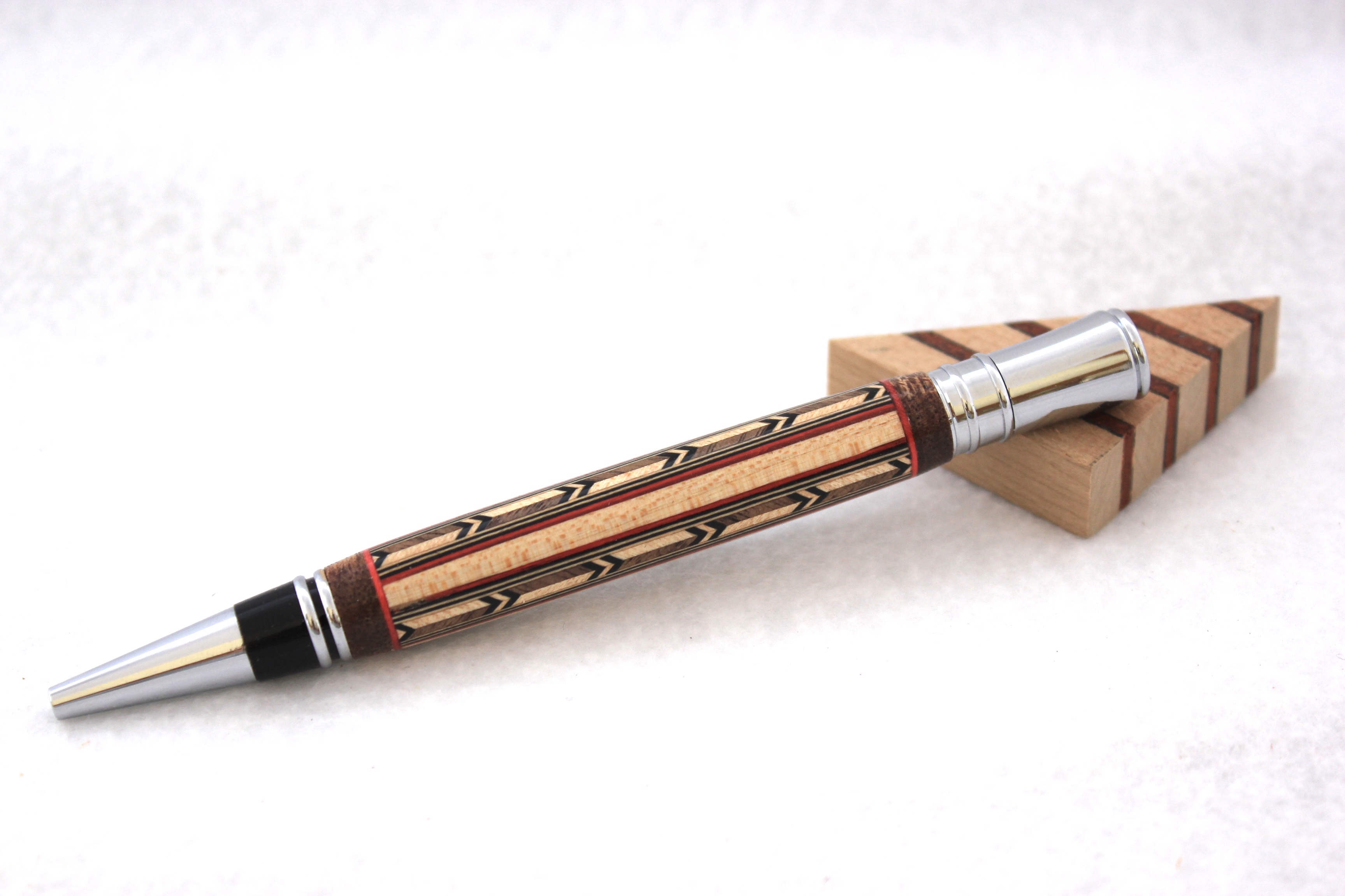

Hi Don. Thank you for the kind remarks; (and I hate snakes, but admire the blanks!)
No, The Executive Kits I have are still press. While I like the kit as the blank is a bit longer and I can show more of the Chevrons, the fit is very tight on both ends and I file the components down for an easier assembly. I have several of these blanks (6 hrs in) that split on assembly, so I don't take a chance, and I always put a solid end cap.

Ah, um, Am I seeing what you claimed as a mismatch on a previous pen to be a feature on this pen?
The dark and light are alternating intentionally all the way through. Well done! Beautiful and skillfully done. Not "hand crafted", but an Artistic Creation!

Actually, the walnut and maple alternate segments are what I wanted this time! Still need to tweek a few aspects, but OK for now.
That is a truly beautiful pen, Mark !!! . Well done, and Congratulations !!!!!
It is another Executive, which you seem to like a lot; and I never cease to be amazed how successful you seem to be with the Executive give the facts that the blank-end material is so thin, and that your chevron blanks are quite fragile (I would think, anyway).
I realize that the solid end rings in your design help to alleviate this potential problem.

You are correct on the thin ends of the Executive Kit. I have about a 90% success rate to keeping the segments from splitting on assembly if I file the components to an easy fit.
Yes, I do struggle with the dimensions for these segmented blanks, and look for longer blanks (to display the patterns) and a thicker shoulder to assist with keeping the segments together.

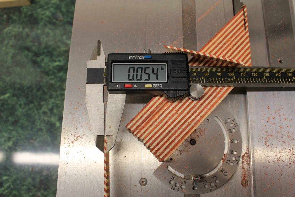

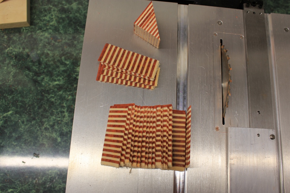

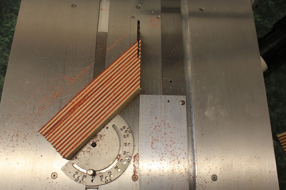

Mark, Beautiful work. I just started making simple segmented blanks. Just curious as to how you cut the small pieces of the segments? Do you have a home built sled? And do you use a table saw or band saw or both?

I have cut the slices on both a regular table saw, and on a Byrnes small table top saw. Both work with a 45 degree sled.
