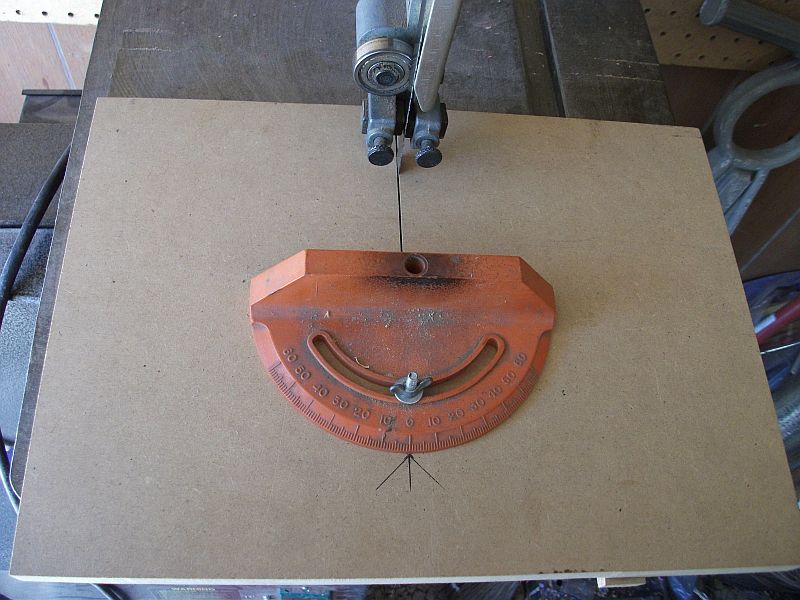

Hi everyone,
After finally getting a new motor for my band saw I felt I needed a sled as well.This is what I came up with.The base is 3/4" composite shelving material with a track guide of the same material glued to the bottom using titebond3.I scavanged an old mitre sled and positioned the backer on center of the cut line.Drilled a hole for the pivot pin to rest in and another for the hold down nut.It gives me 120 degrees of pivot in 1 degree incraments.

Neat idea, i love the sled on mine, you can do some real nice cuts with it that you otherwise would not be able to do. I will have to incorporate your style onto mine. How are you going to stop the blade from running into the miter gauge. On mine i have a block glued on to wood fence high enough so it hits the blade guard which stops the forward movement. Nice idea on yours. carl
The mitre gauge makes contact with the knobs keeping it from running into the blade.Perfect for inlay work.If I wan to go deeper I just use some sacrificial lumber.

It cuts as smooth as a bandsaw can I guess.I'm using a Olsen 1/2 6tpi blade.I'm working on a blank now 14 inlays with at least 10 to go.we'll see how it turns out later, I got to finish up a flash light first.
