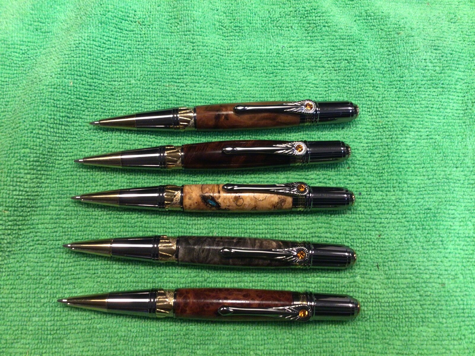

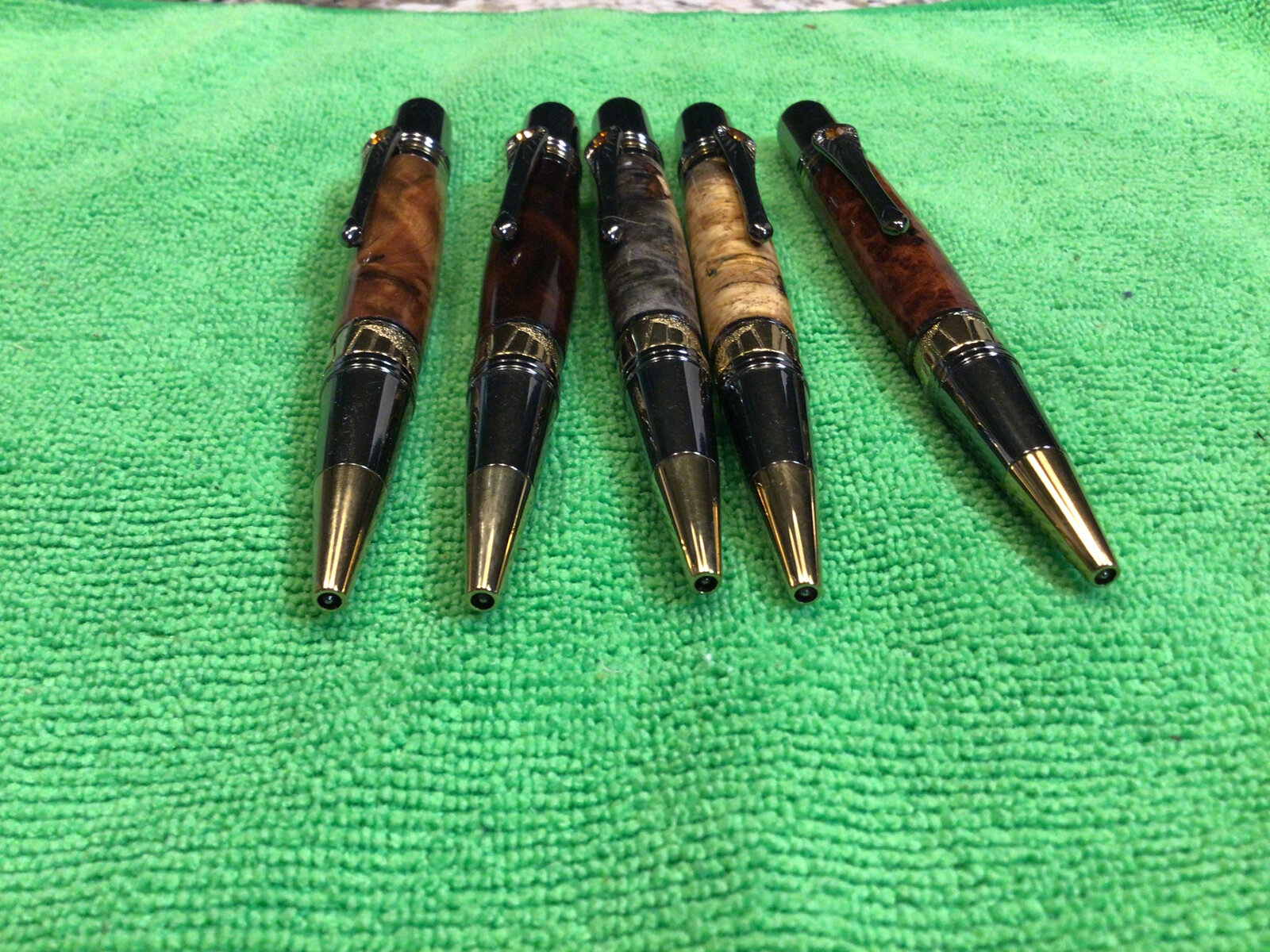

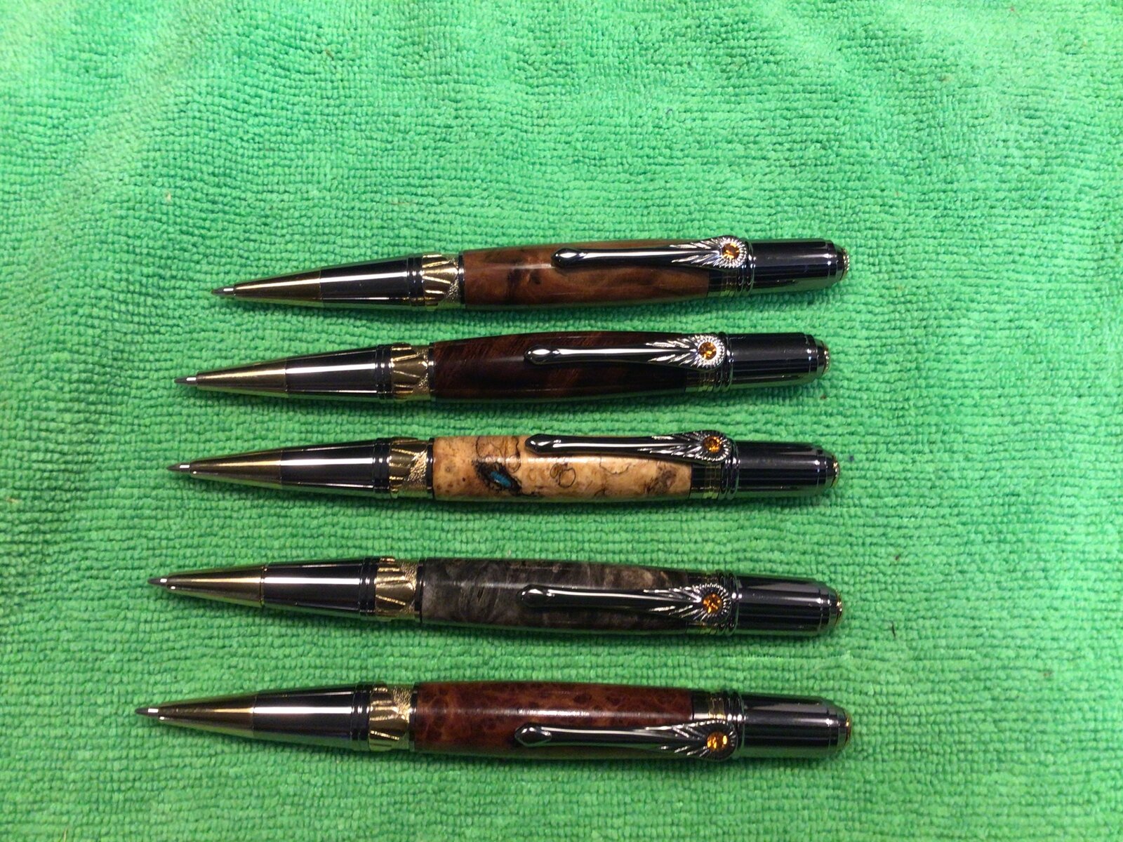

No I did not over trim these. Here are five Art Deco ballpoints I completed today. As you can see the refills extend just a skosh too far, and barely retract inside the nib opening. I'm considering using some blue loctite and backing off the twist mechanism a turn or two.

Do those pens have the kit-supplied refill installed ?
If so, before you alter the pen in any way, you might want to try a high-quality refill in each . . . perhaps the Schmidt 9000.
Also check the fit of the spring on the refill. . Some springs have a narrow end .. reversing the spring might make a difference.
Just a couple of things to think about, if you haven't already, and try if appropriate.
Thanks for the suggestions, Mal. Tried both with same result. I am curious if anyone else has experience this with the AD ballpoint. I know I did not over trim them.
Try trimming off the plunger that extends and retracts inside the mechanism.
Good idea if I could figure out how to do it. The top of the plunger is at least 1/8 inch below the opening of the mechanism when in the full extend position. Suggestions?
Is the transmission a press fit? Maybe it's pressed in a bit too far? If it's a screw-in, I don't have any suggestion other than a workaround - I have snipped some off the bottom end of the refill (the plastic portion) - I do this gradually, until it gets to the correct length.
Screw in, Kevin. Snipping off the end of the refill is not a good selling point, and a good way to ruin one's rep when the owner has to replace the refill.

So it would seem, from your reply to my suggestions above, that the refills you're presently using have the correct length.
ONE thought .....
It looks like the excessive protrusion of the refill is roughly a millimeter or so . . . about 0.040" +/- . . . perhaps a bit more.
Researching the correct brass tube length . . . . thinking that maybe PSI provided the wrong brass tubes in those Art Deco kits.
I think that's an unlikely possibility, but it might be worth checking . . . . with approximate . . but close . . actual measurements on the pens.
I checked the PSI instruction sheet. . Usually they specify the brass tube length . . . . but not in this case ( Art Deco ballpoint ).
However, the length is stated in a file here in the IAP Resources . . . which gives the length as 1.991" . . . darn close to 2.00"
If you have a good set of calipers . . . and without disassembling the pens . . . you should be able to measure the barrels on the above pens.
IF there is a discrepancy . . . a phone call to PSI would be in order . . . not that they can do much at this stage, other than replace the kits.
SECOND thought .....
From the instruction sheet, I get the impression that the transmission screws into the top end of the COUPLER piece.
IF disassembly is possible, and the COUPLER is removed from the pen barrel . . . . . a "washer" of the correct diameter and thickness
could be placed over the lower end of the COUPLER, effectively adding length to the barrel.
But you'd want to be sure lengthening the barrel in this way wouldn't be problematic in the future when replacing the refill.
One thing you'd have to be absolutely sure of is that the present refills are indeed the correct length, and match a "standard Parker".
THIRD thought ..... re: your own thought "I'm considering using some blue loctite and backing off the twist mechanism a turn or two."
Before you do that, you'd want to be darn sure that your refills are the correct length . . . thinking ahead to future refill replacement.
Just trying to think through the problem you are having . . . . rather a tricky one. . . . I think a phone call to PSI would be appropriate.
I hope you will inform us of what "solution" you eventually come up with, John.

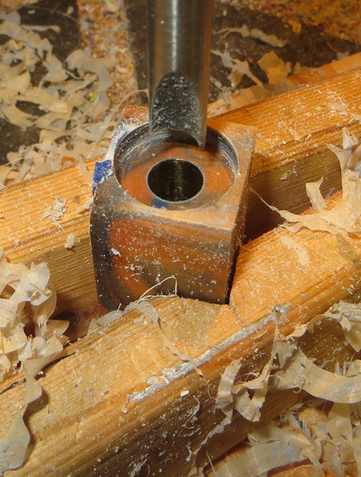

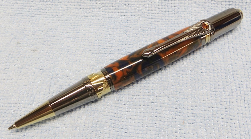

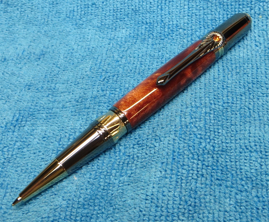

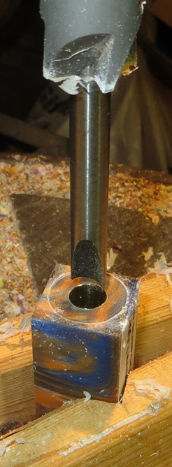

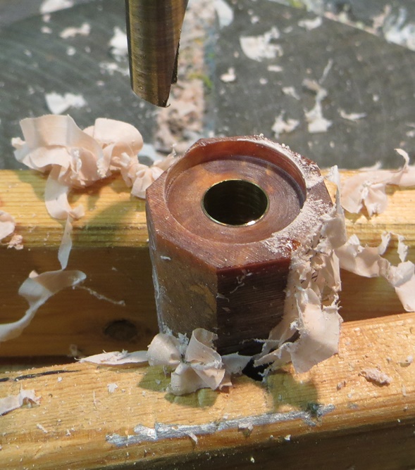

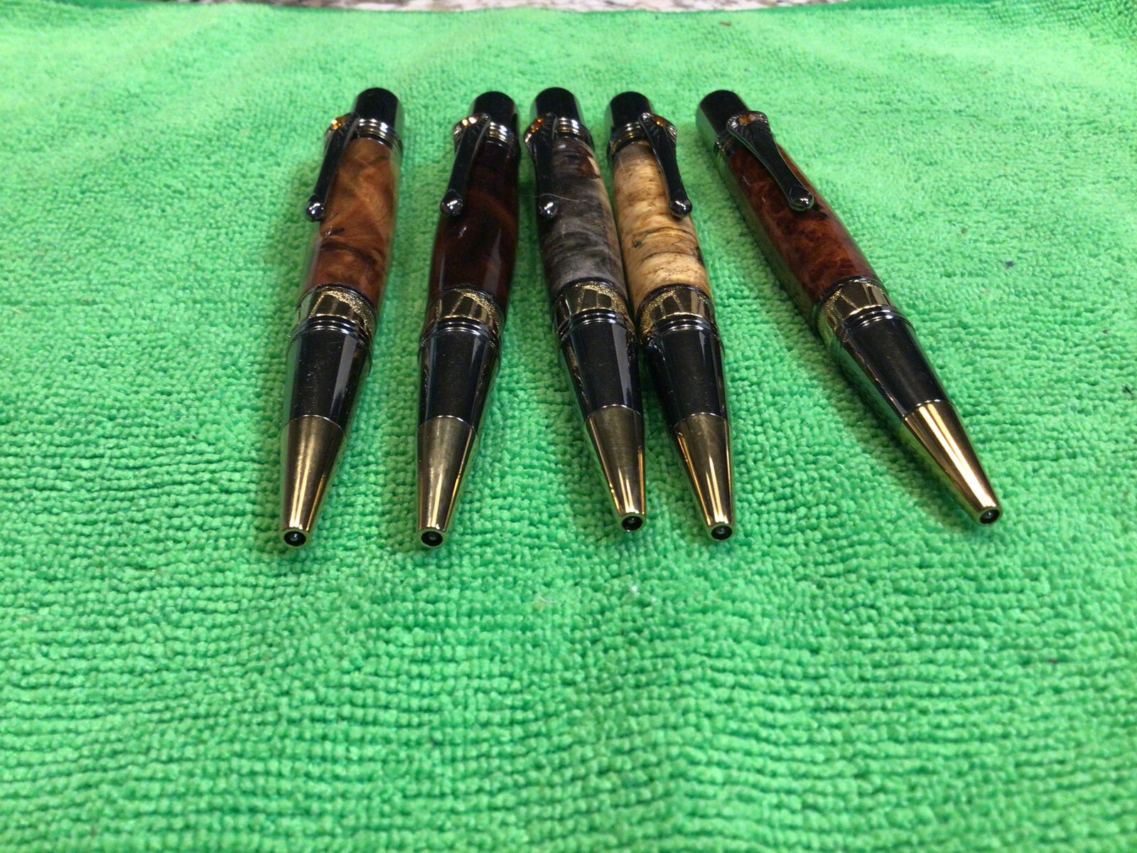

I haven't made any Art Deco pens since 2016. I no longer have them in my possession. I do have some photos, however, but unfortunately none of them with the refills retracted. Extended, it looks like they do stick out a little more than other pens, but not as far as yours. Like all pens, I trimmed them just until the ends of the brass tube were shiny. So I don't know what happened with yours. Are you sure you didn't trim them a little too much?

I measured the blanks as you suggested. They all come out to about 1 63/64 inches (1.984), well within the measurements called for in the IAP app. I am mystified as to why the refills extended so far. The only thing I can think of is that the t.uses need to be about 1/16 " longer. I decided to go the loctite route. I applied loctite to the mechanism threads, screwed it in all the way, and then backed it out two revolutions. Let them sit for a couple of hours, and now good to go. Now off to PSI for a review.
Positive. Used the me technique as you, using a Woodpeckers barrel trimmer.
Mal,
Two revolutions might not be quite enough, as the threads on the mechanism are very finely pitched . . certainly worth a try.
Let us know the result, please.
I guess with blue loctite you can always remove the part . . . . with a bit of effort . . . . if you have to.

Frank's solution is the way to go. I used red loctite and backed off the mechanism two revolutions. As Mal suggested earlier, this was not enough, as the refill still protruded too far for my liking. As I now couldn't unscrew the mechanisms, I unscrewed the nib, removed the refill, and using a 15/64 bit by hand, shaved the plastic insert down, rechecking often until I was satisfied. Five pens ready to go. Thank you everyone.
