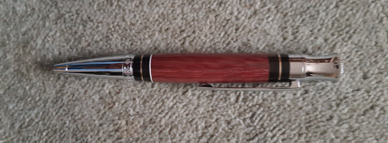

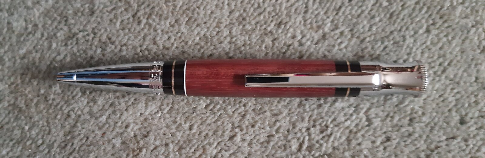

Another Brass insert and a CC. I quite like working with Brass for all its problems but I have some Aluminium on order and want to combine the two.
A note gluing and drilling I have modified the point on my drill and used my new expensive Epoxy and still had separation on drilling. When this happens I re-glue with CA Thick and every time it holds.
I am a little confused does it mean CA is better holding metal to wood than Epoxy.
Please feel free to comment.

Looks very good ! ! !
What pen kit did you use ?
Mal ita a Samsara from UK Pen Blanks.
ukpenblanks.co.uk
They also trade as Greenvill Crafts.
It's a well made kit very positive twist mechanism.
Thanks for your comments.
Mike

I like the rings! Maybe when you get the aluminum you can try a 3-ply sandwich ring (Al/B/AL; B/AL/B). Will test your CA/Epoxy technique.
I prefer epoxy (well cured - 24 hr) for metal/metal or metal/wood. I have issues when I drill through and heat loosens the bond. This is why I drill all my rings separately and glue onto the tube, layer by layer and clamp.
Very nice pens! 👏 👏 👏

Thank you for your comments I think that metal does not absorb the Epoxy / CA and this makes for a bad bond. I am careful not to generate heat but still get a breakaway and when you examine the break you can see there is no adhesion.
I like your suggestion for a 3 ply sandwich. Also pre drilling the metal but I don't have a Bench Drill all my drilling is done on the Lathe.
Thanks again Mike.
