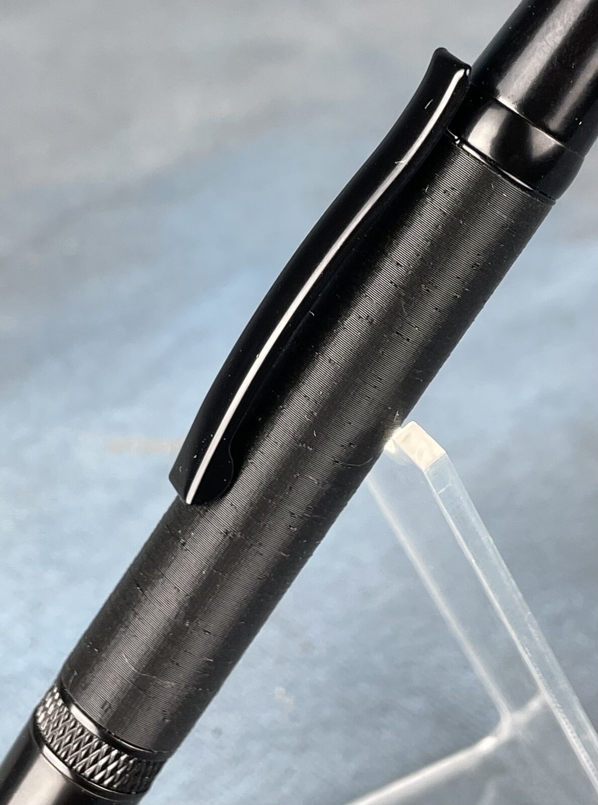

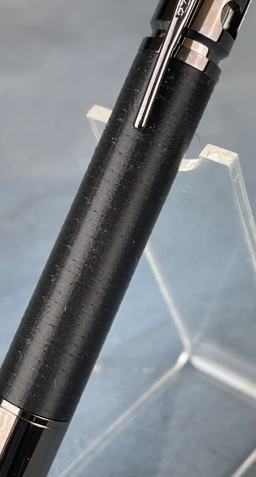

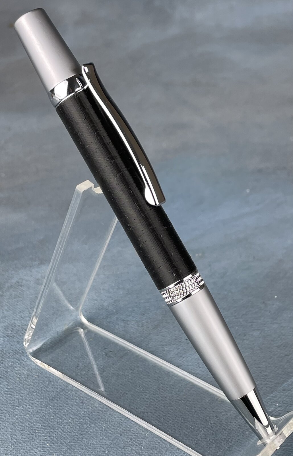

This blank was 3D printed in black resin. After a few trials to get the dimensions just right, the brass tube very tightly fits inside the 3D printed tube and the outer diameter matches the kit. The fit is tight enough that no glue was used and the pen was pressed together. Not likely to move since the fit is from the brass tube and the hardware does not allow movement.
I'll see if it grows in me. Definitely different and definitely easy. It takes 40 minutes to print.

I think it looks cool. When I was looking closely at it (before I read your post), I thought it was a thread wrap, like they have for fishing rods. Do the layers of 3d resin give the pen more grip? It looks like they might.
Anyway, this juror gives a thumbs up! :)
Sold it! Jury votes yes now. Costs less than a blank with relatively no work now that the design is correct.
The blank was made layer by layer from the bottom of the cylinder to the top. It does feel grippy!

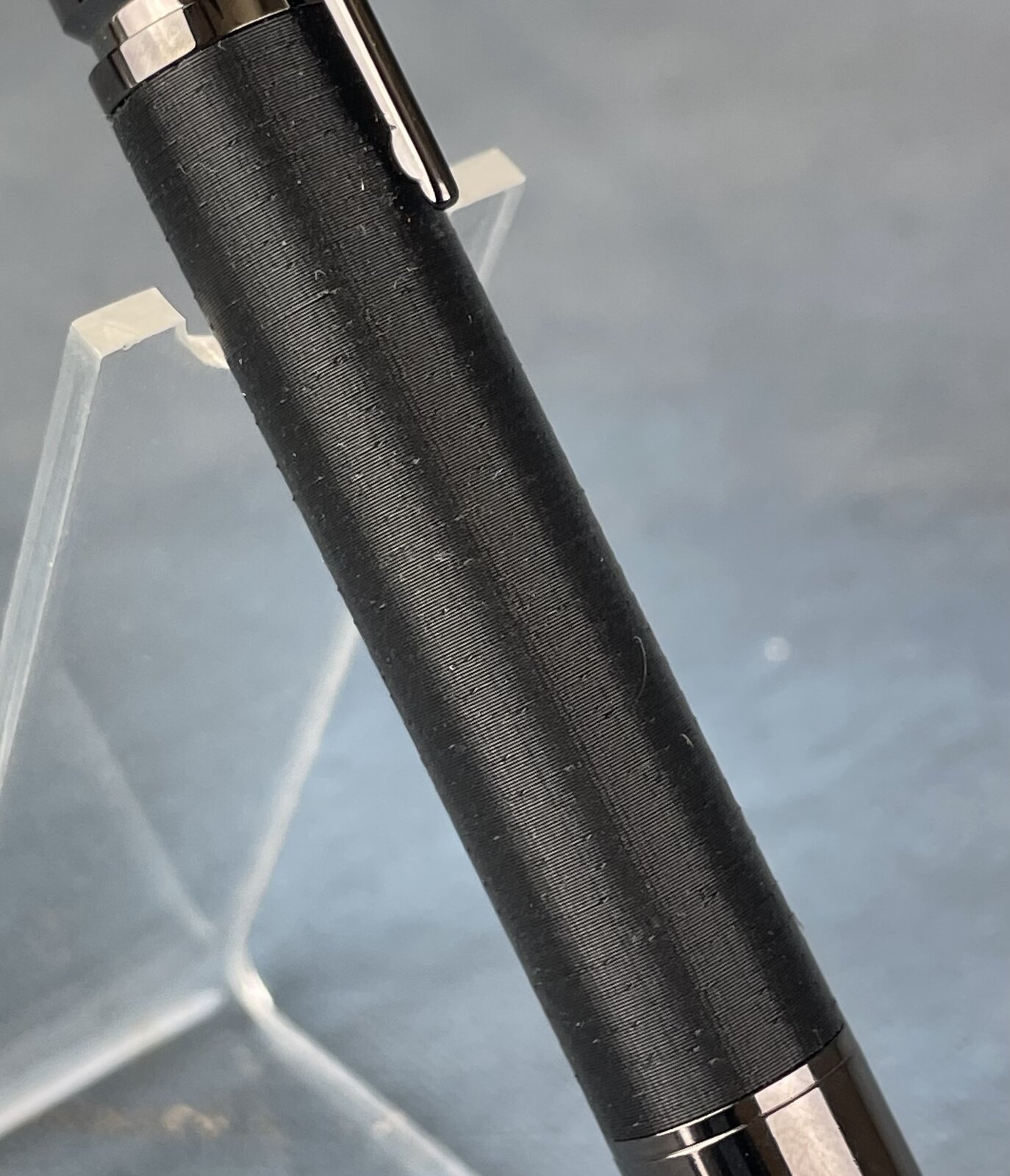

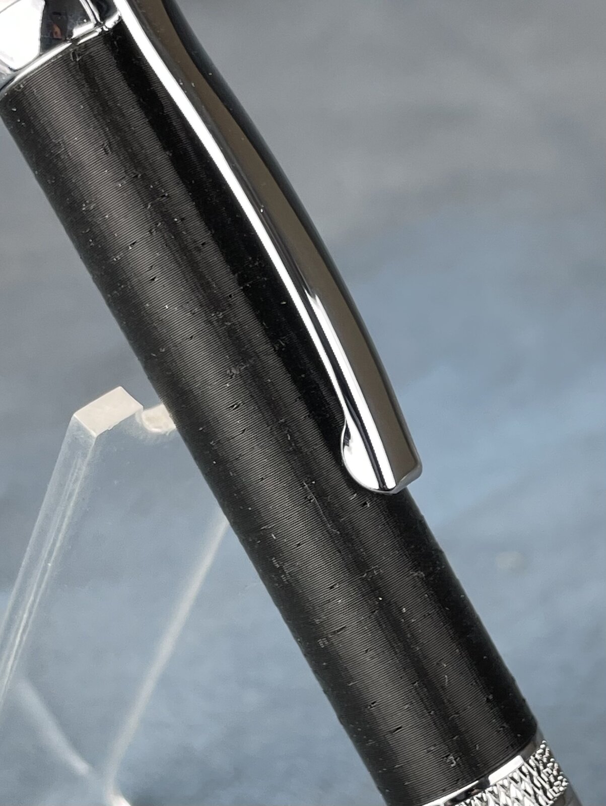

Interesting! I imagine you could do quite a lot if you could use multiple colors of filament.
Curious if you can optimize the printing process to not leave the little "threads" on the blank?
You can hit the blank with a heat gun to remove some threads. I'll try it on the two I made today. The printer randomly starts each layer so you see a slight nub where that occurs. I could force it to line those up like a zipper.

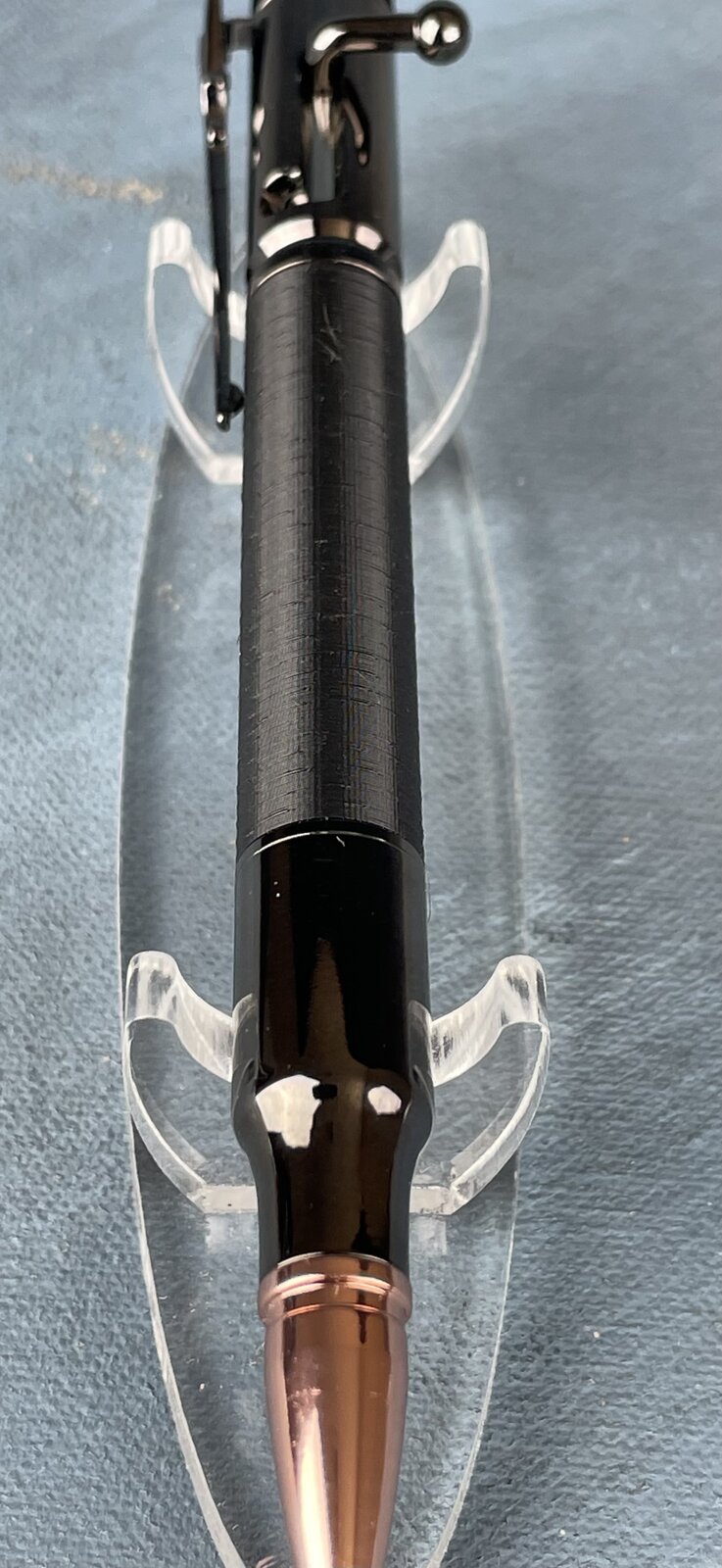

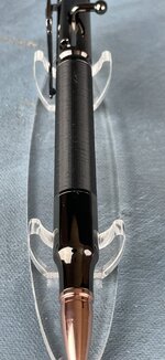

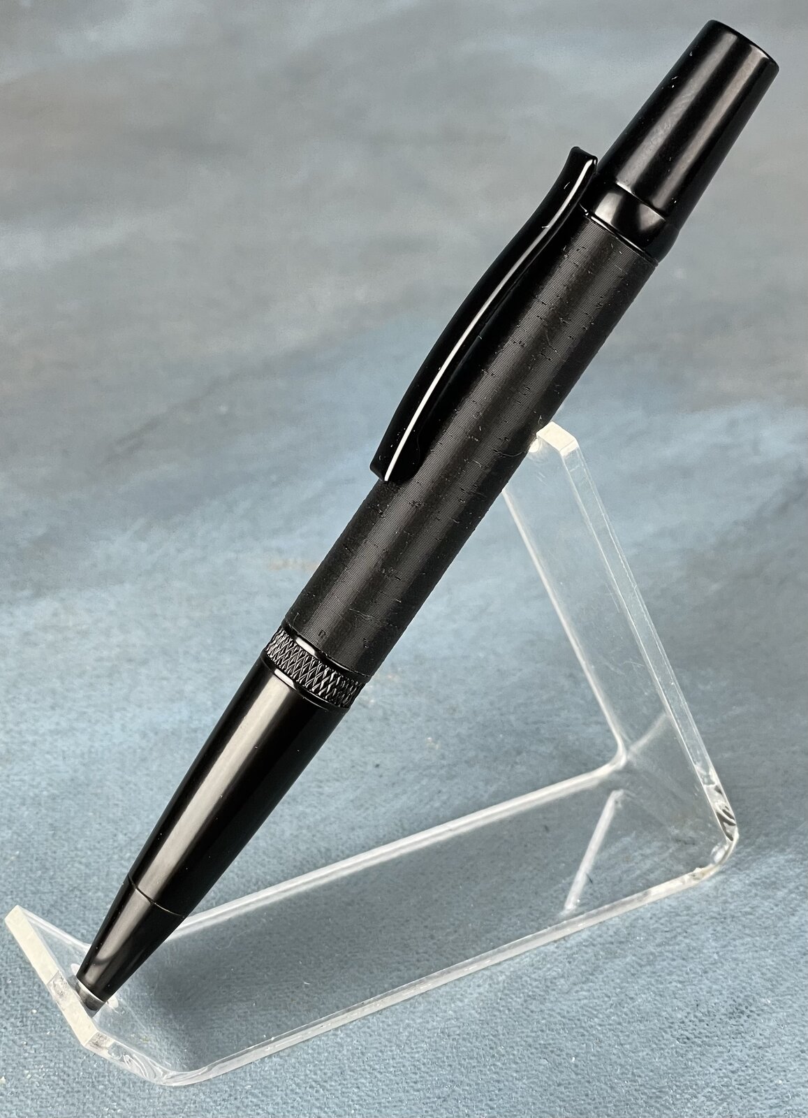

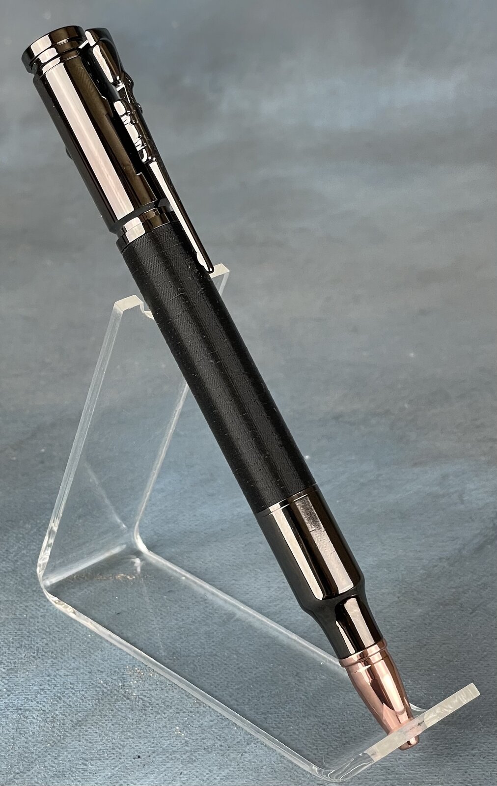

Two more. This time I tried the very thin diamond knurl ballpoint/Sierra pen body. The cylinder of extruded plastic had a very thin wall as expected, but it worked. The tube goes in quite firmly and does not want to move once installed. Photos below. It indeed looks like threads are hand wrapped around the tube like fishing rods. I fish so that it a plus to me.
After selling the first 3D printed bolt, I made two more in black and again in gun metal.
This will by no means replace beautiful burl wood or interesting acrylic, but the right buyer will pick them up and no let go.

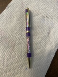

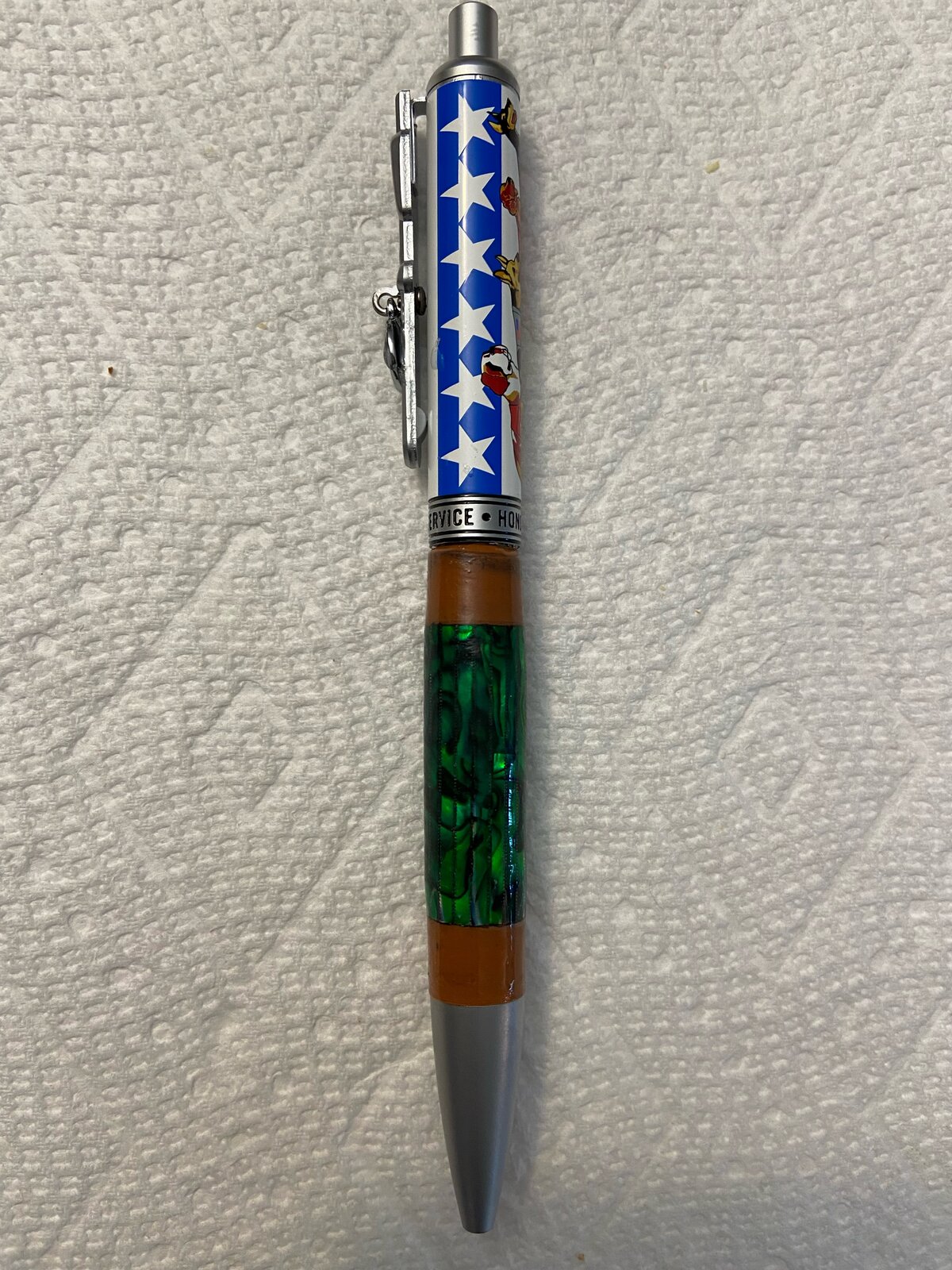

This is very interesting, I started printing pens with the thought of doing an abalone warp. I have printed in blue PLA and various wood infused PLA. It was fun using TINKERCAD to generate the designs, lengths and size for the "turnings" for each type of pen ( slimline, K9, Patriot, Baseball etc) . One the design were done I printed them on an Ender 2 Pro ($199) with a wood infused (30%) PLA filament. I tried various sizes of Abalone inlay areas from 20 mm to 35 mm long. My worst problem was get the ends to a size equal to the diameter of the items being pressed
into it. Like you I found that with proper specifications the brass tubes could be inserted so tightly that glue or adhesive was not required.
I would then take Abalone sheets that would match well with the shades of the "printed barrels" and cut them on my laser. I used a stitching cut to "cut" the line, 1mm cut skip 2mm and repeat (it is a setting in printing software LightBurn). Power was adjusted so as to cut the abalone without cutting through the backing . Once Abalone was cut, I wrapped it in the insert area of the printed barrel. Unlike Mark I would then add a layer of UV resin and cure it in a Resin Printer Washer/Curing station for 20 min. I would then wet sand using the micro pads from 320 to 3500.
I would repeat this process until I had covered the Abalone and sanded 3D printed barrel. Once it was Smoothed and Sized I added 2 light coats of Gluboost filler CA and then followed by 2 coats of thin CA. This last step caused me a lot of grief until I learned not to use excessive accelerator.
K9 pen shown below (brown is the 3D printed part and green is Abalone)

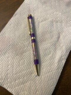

Latest pen made for my son's birthday. Used purple filament and cream abalone
