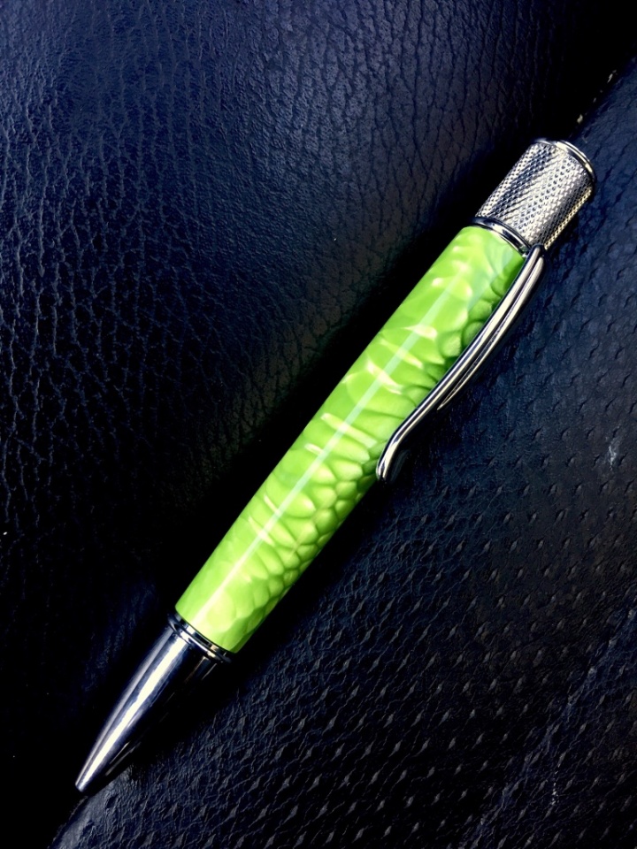

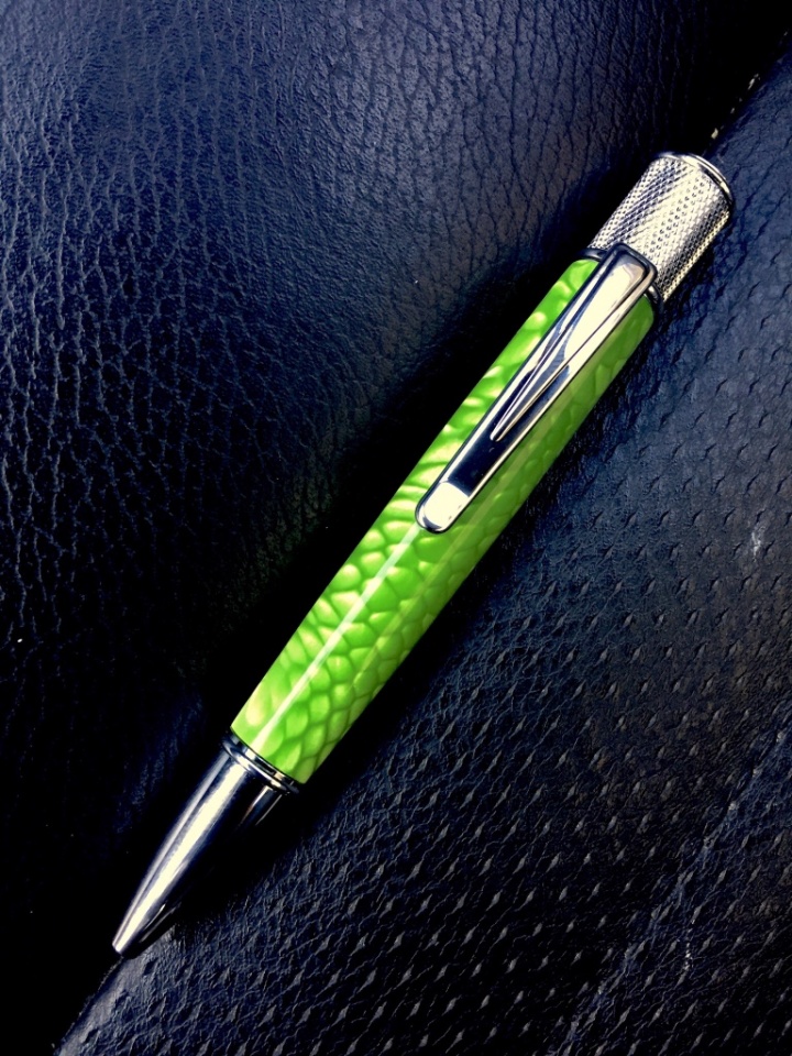

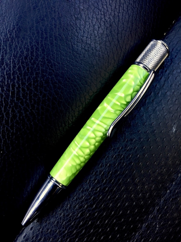

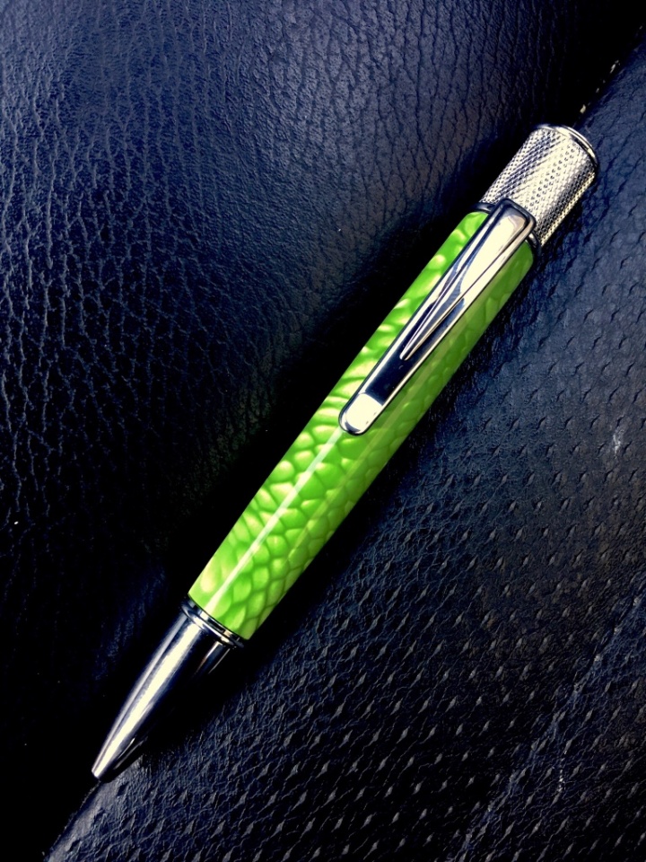

I went to hobby lobby and found an acrylic paint the same color as the lighter color of the blank. Here is the result. Make sure to let dry a day.

Hello Dan from down south of Houston in Santa Fe (Texas of course).
Thanks for the great pics of Juma pens. Your work is superb.
It appears that green tubes do not diminish the pattern at all. It looks quite pronounced, which is what I want.
You have been a great help.
I'm sure Ed and Dawn can educate us both even further.

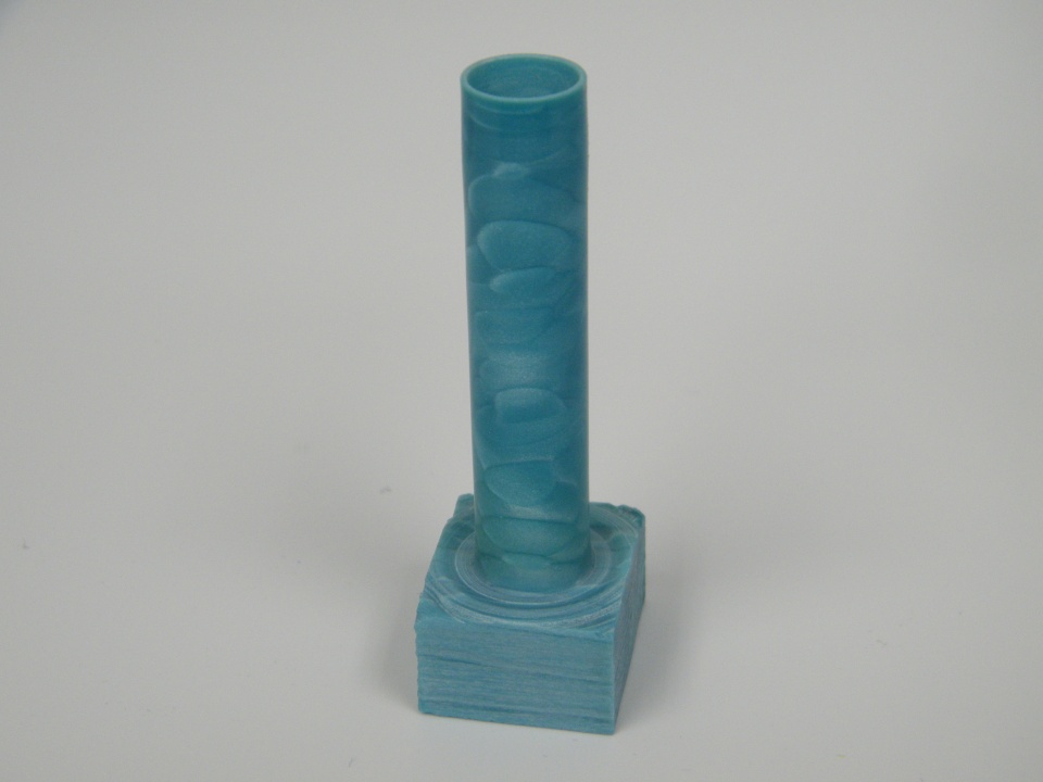

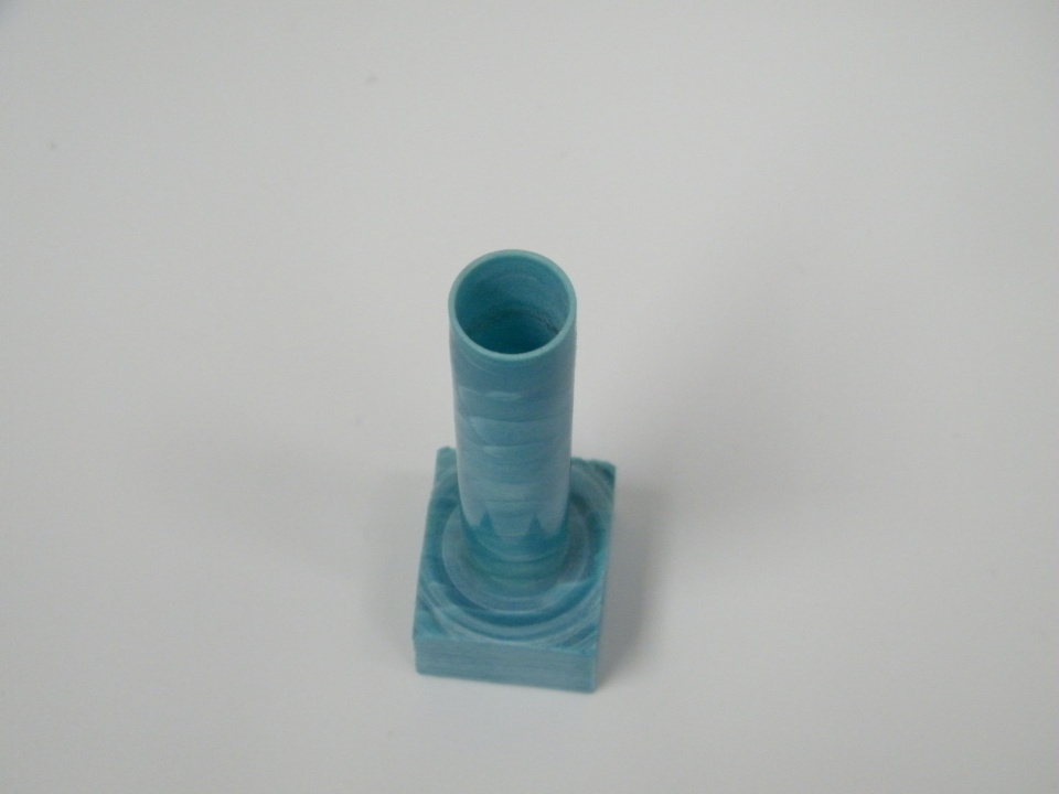

I took a light blue blank and drilled it for a sierra tube (10.5 mm=.4134")
Then turned it without a tube, to the finished diameter (.48")
Clearly, this leaves a wall thickness of .0333" (.48-.4134=.0666/2=.0333)
Polished as if I was making a sierra --looks GREAT!! Then took black, white, chrome and normal brass tubes and inserted. The difference is minimal. Perhaps the black brings out the figure a minuscule amount, but I doubt anyone could tell unless you had two in your hand to compare.
I will do more with this, using other colors just to confirm, but presently I don't think painting will matter a great deal. Because there is a pattern, I would still paint at least the tube in case there is a clear spot in the pattern when complete--but that is just a lot of experience with acrylics being super-cautious.
Will post pics of the blank. Right now I HAVE to get the Sunday email done!!!!
Ed

I am interested in your turning too. You say you turned without a tube in the blank.
You turned down to a wall thickness of 0.033".
That is quite a feat. The acrylic would have almost no strength/stability at that thinness.
Did you turn down only a short portion of the blank, leaving the rest thick for strength ?

Let's say I am pretty comfortable with acrylic!! I'll post pictures when I have time this week.
The section that is turned is 2.19", There is a 3/4" square at the end that was in the chuck to keep it turning.

Looks pretty fragile.
You probably supported the open end with a live center while you were turning .... yes ?
Or perhaps you even slid a spare brass tube temporarily into the hole also.
Yes, I did use a live center to gently support the end. I considered using a tube but decided it really had no advantage and would keep the live center from doing much good.
As they say, sharp tool, light cuts. Skew from start to finish, although at the end it was a half inch skew that was very, very sharp.
