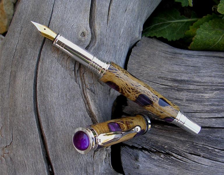

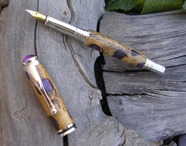

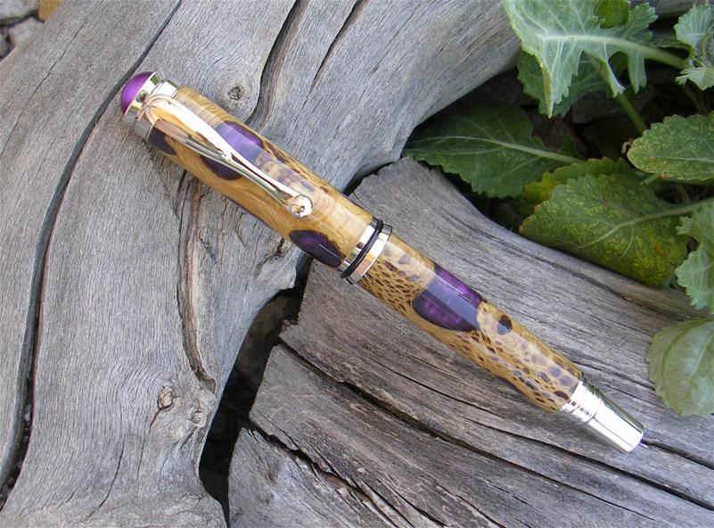

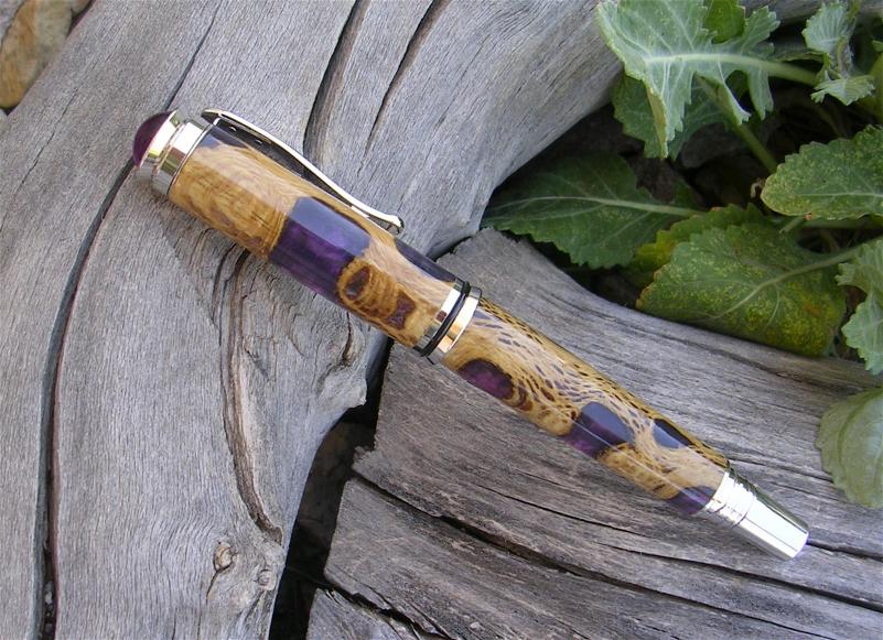

I made this Jr. Retro using a cast cholla blank I got in a trade from an IAP member. It's my first pen using a blank like this.
It was a learning experience but enjoyable. While I was at it, I decided to try and match the resin color with a new end cap button.( There is probably a more appropriate term but I don't know it yet )
The fit is a bit off most likely because of the CA finish applied. It will work out fine as a carry pen for a nimrod like myself.

Dang Jim, that looks great. Really glad you liked the blank. Great job matching the Lavender color. I am actually working on a Giant Cholla Retro too and was looking at the finial and trying to figure out how to get it out.

That is one nice pen. I love doing cap finials. Yours looks perfect. Normally, I'm not a big fan of purple, but I think this is one I'd carry. Plus, I really like the jr reto style.
The finial on mine was made of metal. I knocked it out with a punch by placing the end cap over a block of maple with a relief hole to support the cap. It came out pretty easy. I used it to get measurements for the finial.
I epoxied a small cutoff onto a longer one so I could turn the finial. Shaped it and did all the wet sanding and polishing before turning down the small stem that positions it in the end cap.
Thanks for the blank Chris. It was fun to make something out of it. I learned a lot on this pen.
