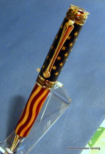

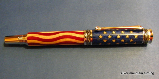

Jr Majestic, black TI.
PSI's Stars & Stripes blank.
CA/ BLO finish.
Comments welcome!
The combination is a bit much for my taste, but had to try one.
I was not overly impressed with the blank for the price, had some color bleed issues on the red stripes onto the white stripes from ca gluing.Got it done though, with minimal transfer.
Thanks for looking!

That is some really nice work. FWIW, I have used thinned wood glue to assemble the stars and stripes on kits like this. That totally prevents color bleed. (Not my idea, I got it from Ken Nelson's instructions.)

Thanks, John. The price is pretty steep for me, also. i have a request from
a coin shop owner my Father is friends with for some pens to sell thru him
in his shop. I will be putting 125.00 on this one.If it sells for that all is good,
if not, there sure won't be any more for me!:)

Thanks, Cav. That thinned wood glue sounds like just the answer, Thanks!
I was about half sick after initial glue up, seeing all the red bleed.
It mostly turned away, enough that it is acceptable. I reasoned that since the ca would bleed the red by itself,that if I used BLO on the blank first to coat/penetrate, then ca it might work ok. It did.
Thanks again for the tip!

Thanks, Lupe. It wasn't as bad as I had it worked up in my mind before I started. The stripes are cake to do.Stars, a gentle touch is required "spearing" them with the exacto knife tip. I pushed thru a couple, blowing them to pieces and said #%&*!! just a little.:biggrin:

Johnny, if you're ever doing another one try using a toothpick with a small bit of bluetac on the end to pick up the stars, rather than a blade :)

John ,got one sitting on my bench, completed, blo/ca'd and stopped because I didn't like the bleeding.:mad: Going to sand it back down and start over.:frown: You seemed to have overcome the bleeding problem. Nice!:wink:
