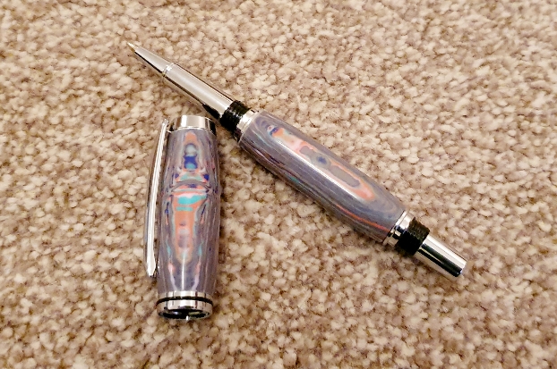

I must admit, I do like these pen kits
Sent from my SM-G973F using Tapatalk
jttheclockman
Feb 22, 2005
19,132
NJ, USA.
Something about that kit and the Baron have been around for the longest of time and still past the test of time. They are a simple yet elegant pen kit It does not overshadow any blank you choose. That is why i like these kits. Nice work.
