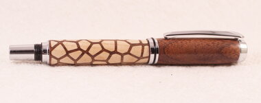

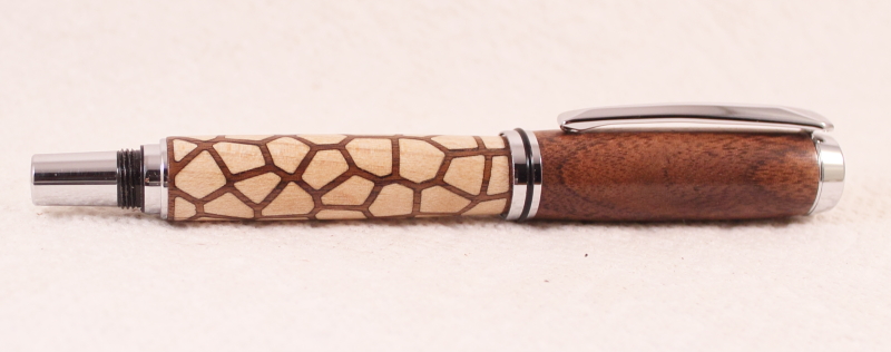

Jr Gent in maple and walnut with laser cut Voronoi pattern. There are 44 inlays in this one and no two of them are the same shape.
Almost looks like a giraffe pattern. I like that you sell your blanks assembled - does it take some time to put them together?
Chris, this one can take some time to put together. I did one about 6 months ago and it took a couple of hours to figure out where the piece go (mainly trial and error). When I do them now I lightly engrave numbers into the pieces. I make an additional blank to use as a legend that I engrave the piece outlines and numbers on. This gives me a quick visual reference and it doesn't take that long to assemble them.
