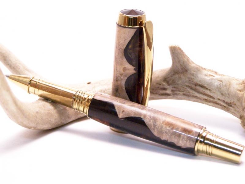

Got a really nice blank from Pat at Ankrom Exotics. Had some problems, Laurenr helped me with the finish. Not good enough to sell, cause I botched the finish so bad before Lauren saved me, but I really really like it and I am using it for my carry pen.
I needed to sand it, much much more, and I think I got it too hot when sanding before the final CA treatment.
Anyway, I think it's cool, what do you all think? Jim

Jim,
I did the same thing on an identical blank with the finish a few months back. I realized that I really needed those Delrin bushings to finish mine out (a Baron)because during the sanding I got that metal bushing "bleed" into the light wood, and once it was there it seemed no amount of acetone would take it out. Yours looks great!
