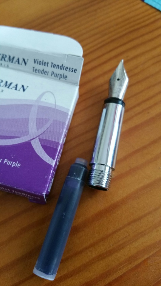

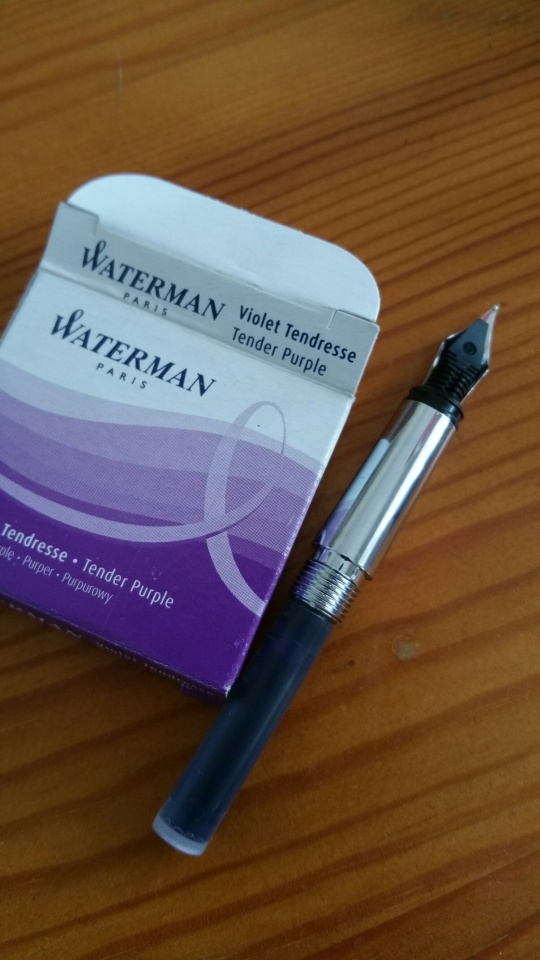

Disappointingly, Watermans don't fit. they catch on the shoulder as pictured

Brad,
I never had this issue with Waterman/Pelikan cartridges and Jr GentII FP's. Instead sometimes I had the same kind of problem with the standard Schmidt converter.
