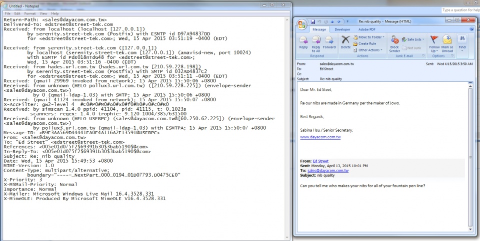

Then in entry number 29, you wrote this:
All dayacom nibs are jowo manufactured.
This comes from dayacom directly and the president of jowo,
How did you get this information directly from the president of jowo, when his name is not in the "what we know about Jowo"?
And who at Dayacom was the source of this information?
This is indeed a sweeping statement and VERY interesting, if true.

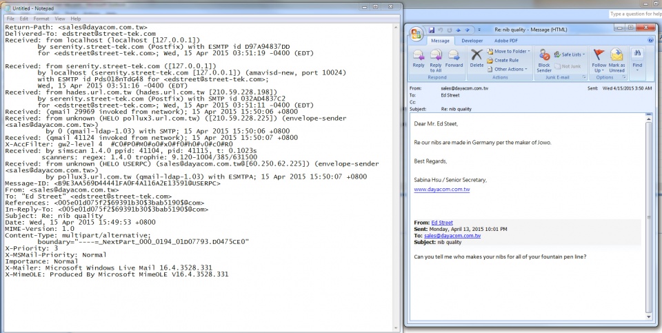

This is the reply
attachment.php
Had to do it as a photo attachment, kept giving me some forum errors
However, you have known this very info for over 1 year now.
